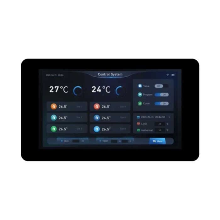

ESP32-S3 7inch 1024x600 Capacitive Touch Display Dev Board (Type B)
SKU: WS-31726 Brand: Waveshare
Build a touch-driven control panel or smart-home dashboard with a big, sharp screen and wireless connectivity on a single board.
$73.26 AUD, inc GST
$66.60 AUD, exc GST
A 7-inch, 1024 × 600 IPS touchscreen with an ESP32-S3 built right in - everything you need for a responsive, polished human-machine interface without wiring a separate display to a microcontroller.
At its heart is an ESP32-S3 module: a dual-core Xtensa LX7 running at up to 240 MHz with 16 MB Flash and 8 MB PSRAM, giving LVGL the memory it needs to drive the higher-resolution panel smoothly. Touch input comes from a 5-point capacitive panel behind tempered glass.
Type B is the upgraded version of Waveshare's 7inch ESP32-S3 board, stepping up from 800 × 480 and adding software backlight control and battery-voltage monitoring. Industrial-style bus connections, a TF/SD card slot and a lithium battery connector mean it can serve as a wall-mounted control panel, machine dashboard or portable data logger.
Getting started is quick: connect over USB-C, then program it in the Arduino IDE or ESP-IDF using Waveshare's LVGL demos and example code.
  • Readable from across the bench, thanks to an IPS panel with a 170° viewing angle and 235 cd/m² brightness
