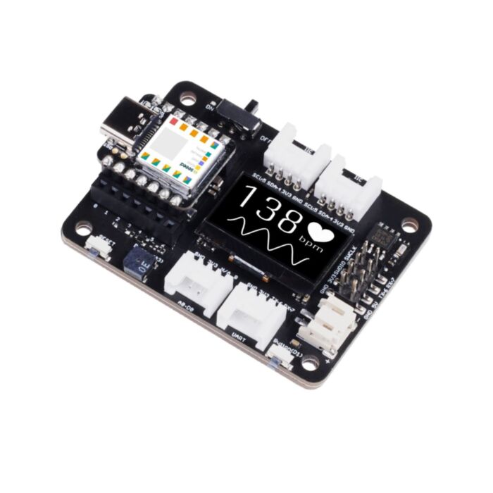

  • Quick Prototyping: Easy debug and Reset with RESET button and SWD pin led out to the male header. 0.96” OLED, enables visual data to display without PC serial monitor.
  • Rich peripherals: OLED display, RTC, expandable memory space, passive buzzer, user button, on board battery management chip… One board on hand to explore infinite possibilities of Seeeduino XIAO.
  • No Soldering Needed: All pin led out. Convenient plug and play Grove connectors support multiple data protocols, including IIC, Uart, Analog/Digital.Circuit
  • Python Supported: Well supports circuit python. Mini SD card slot enables memory space expand, making it possible to allocate more libraries needed in prototyping and project building.
  • Mini Size: Compact and elegant with only half Raspberry Pi 4 size, perfect for tiny and wearable projects.
Description
Seeeduino XIAO Expansion Board is a powerful functional expansion board for Seeeduino XIAO of only half Raspberry Pi 4 size. It enables build prototype and project in an easy and quick way. With its rich peripherals, you could explore infinite possibilities of Seeeduino XIAO. Circuit python is also well supported by this board.
Many users adore Seeeduino XIAO because of its mini size and elegant design, so we try our best to keep the size as mini as we could when persuing the powerful function and rich interfaces. As you could see, the board is of only half Raspberry Pi 4 size.
Rich Peripherals on Board Including:
  • OLED display: Visual data display without connecting to PC, which enables debug in a more efficient way, and builds application such as a sensor hub, data monitor system, .etc
  • RESET button: No more jumper wire and short circuit, easy reset with just one click.
  • SWD debug: SWD pin led out as male pin header, making debugger connection and firmware download much easier.
  • High precision RTC: High precision real-time clock with battery backup, enable maintain accurate time when the main power is turned off.
  • Expandable memory: With a MicroSD card slot on the back, no worry about the memory limit any more when adding libraries and using circuit python.
  • User button: Besides the RESET button, also provide another user-defined button.
  • Passive buzzer: Same passive buzzer on Wio Terminal, with which you could change the PMW frequency to award different beep sound to get a "buzzer music".
  • Grove connectors: All pin led out, plug and play grove connectors support common data protocols (Grove IIC2, Grove UART1, A0/D0 Grove*1)
  • Lipo Battery Charging: JST2.0mm standard lipo battery connector and battery management system, supports both USB and lipo battery power supply, and easy onboard battery recharge.
  • 5V servo connector: 5V output led out to male header for 5V servo and sensor connection.

Item Detail
Power Supply 5v / 3.7V Lithium Battery
RTC chip PCF8563T/5
RTC battery CR1220
Expandable memory MicroSD Card
Screen 0.96 OLED display
Other External Equipment Passive buzzer, user button, 5Vservo connector
charging current Max: 460mA
Grove Interface Grove I2C *2, Grove UART *1, A0/D0 Grove *1
