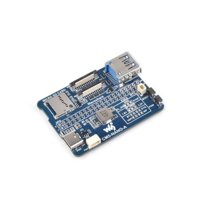

Discover the Nano Base Board (A) for Raspberry Pi Compute Module 5 – a compact, fully featured breakout board designed for rapid evaluation or seamless integration into space-constrained applications.
Its 55 × 40 mm footprint hosts multiple high-speed interfaces, power-management controls and expansion headers, making it ideal for prototyping, embedded OEM designs or advanced maker projects.
Technical Specifications
  • CM5 socket: Supports all Raspberry Pi Compute Module 5 variants (Compute Module 5)
  • Power input: 5 V via micro-USB (also used for eMMC programming)
  • USB: USB 3.2 Gen 1 Type-A port
  • GPIO: Standard Raspberry Pi 40-pin header
  • MIPI: Two 4-lane interfaces (22-pin 0.5 mm FPC) for CSI/DSI modules
  • Storage: TF card slot for CM5 Lite variants
  • Fan header: 4-pin JST-SH PWM
  • Controls: PSW (power) button; BOOT button for eMMC burn mode
  • RTC: 2-pin JST-SH battery header
  • Indicators: Dual-colour LED (power = red; activity = green)
  • IO-VREF: Selectable 3.3 V or 1.8 V logic level
  • Special pins: Core power enable; ETH SYNC
  • Dimensions: 55 × 40 mm
    CM5 Nano Base Board dimensions
How to Use/Installation
  1. Insert your Compute Module 5 into the board’s CM5 socket, ensuring correct pin alignment.
  2. Optional: Fit a TF card with a pre-burnt OS image into the slot (for Lite variants).
  3. Connect peripherals via USB A port, GPIO header or MIPI FPC connectors.
  4. Attach a 5 V micro-USB power supply. Hold BOOT button before power-on to programme eMMC, if required.
  5. Connect a PWM fan to the JST-SH header for active cooling in demanding applications.
  6. Use PSW button to cycle power; monitor system status via dual-colour LED.
Compatibility
  • All Raspberry Pi Compute Module 5 variants (CM5, CM5 Lite with/without eMMC)
  • Raspberry Pi HATs and GPIO accessories via 40-pin header
  • MIPI-CSI cameras and DSI displays (22-pin FPC)
  • USB peripherals (storage, networking, input devices)
  • RTC backup batteries (2-pin JST-SH)
What’s Included
  • Nano Base Board (A) for Compute Module 5
  • 2-pin and 4-pin JST-SH cables for RTC and fan headers
  • Set of header-pin jumpers for IO-VREF and function enable pads
