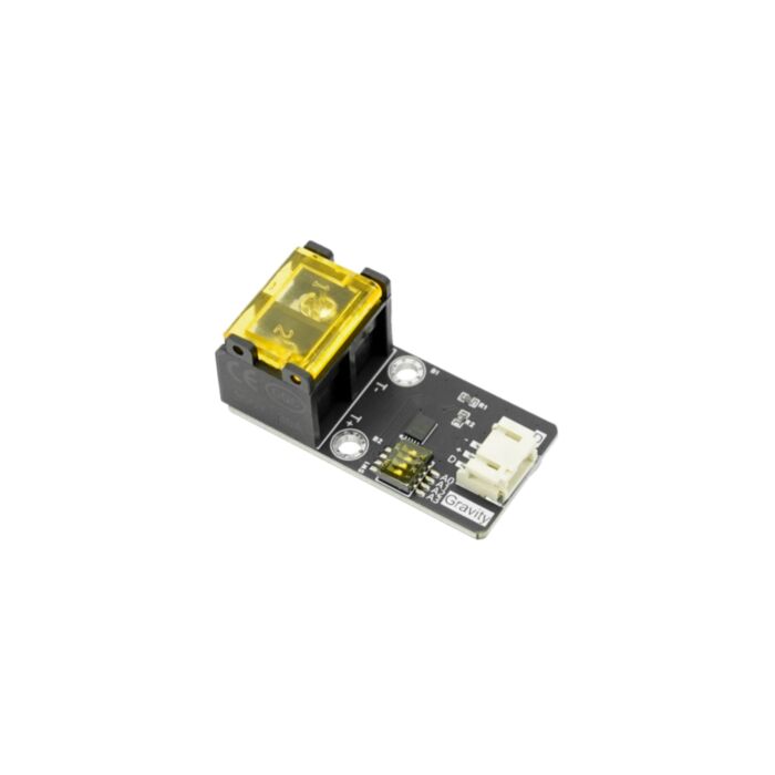

The Gravity CT1780 is a cold-junction compensated thermocouple amplifier that makes monitoring extreme temperatures from -270°C to +1372°C straightforward and scalable. It accurately digitizes signals from a K-Type thermocouple, providing 0.25°C resolution, and transmits the data over a simple 1-Wire communication bus. This 1-Wire protocol allows multiple sensors to be daisy-chained on a single data line, perfect for monitoring various zones in industrial ovens, ceramic kilns, or scientific flame analysis. An integrated DIP switch further simplifies identifying individual sensors in a multi-point network, making complex setups manageable.

Similar to the widely adopted DS18B20, the CT1780 amplifier utilizes the 1-Wire communication interface. This design drastically simplifies system wiring, requiring only a single data line to connect multiple sensors to a host controller. This architecture is ideal for projects that demand temperature monitoring across several distributed points over a wide area, as it conserves microcontroller I/O pins and reduces wiring complexity.
Effortless Sensor Identification with Onboard DIP Switch
A common challenge in multi-sensor arrays is identifying which physical sensor corresponds to a specific data reading. The CT1780 solves this by integrating an onboard DIP switch. In addition to the unique 64-bit address inherent to the 1-Wire protocol, this switch allows for the setting of a simple, user-defined address. When multiple CT1780 units are connected in parallel, this feature enables straightforward visual identification of the sensor currently providing the temperature reading, streamlining setup and debugging processes.

Engineered for demanding thermal applications, the amplifier supports the full K-Type thermocouple measurement range from -270°C to +1372°C. The onboard cold-junction compensation ensures high accuracy across this spectrum, achieving a measurement error of =±2°C within the critical -200°C to 700°C range. With a 14-bit resolution (0.25°C), the module provides the precision needed for process control and monitoring in extreme temperature environments.
