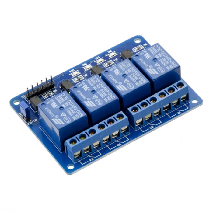

A versatile relay board with opto-isolated inputs. Each channel can switch up to 10A @28VDC
$6.40 AUD, inc GST
$5.82 AUD, exc GST
Delivered by Tue, 27th of Oct
  • 5+ $5.70 (exc GST)
  • 15+ $5.53 (exc GST)
64 from local stock, supplier stock; your order will dispatch . And yes, stock levels and lead times are accurate!
A versatile relay board with opto-isolated inputs. Each channel can switch up to 10A@28VDC
  • While marked as requiring 5V supply and logic, we've found this board to work fine at 3.3V
  • Features a jumper to disconnect the VCC line from the transistors driving the relays, effectively giving you a way to "dry-run" this module
  • Features opto-isolators and transistors to drive the relay coils, meaning that you only need 2mA per pin on your microcontroller to drive it
  • Dimensions: 73mm x 54mm x 19mm
  • Optoisolator/LED Current Draw: 2mA per relay
  • Relay Coil Current Draw: 60mA per relay
