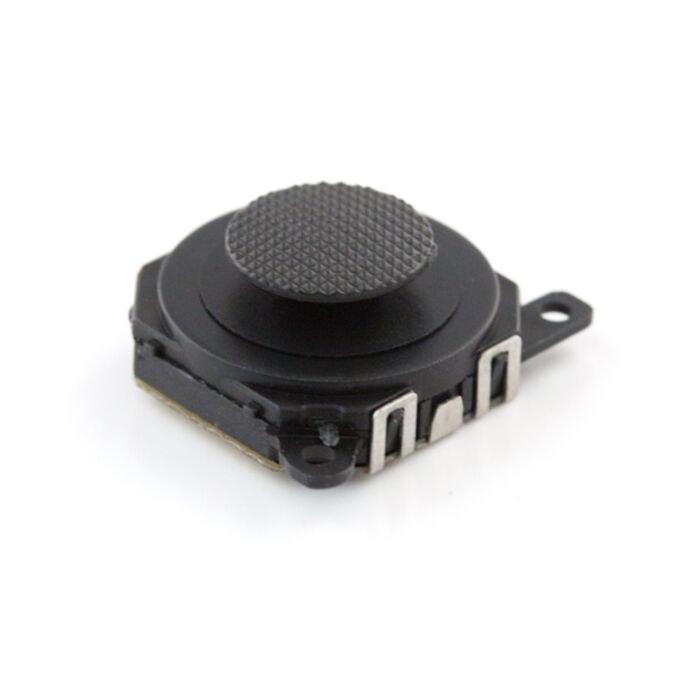

This is a resistive analog joystick, very similar to those found on the PSP1000. These compact joysticks are different in that they have a very interesting ‘slide’ feeling.
$9.90 AUD, inc GST
$9.00 AUD, exc GST
Expect dispatch between Dec 02 and Dec 08
  • 5+ $8.73 (exc GST)
  • 25+ $8.55 (exc GST)
  • 100+ $8.19 (exc GST)
From our customer regarding pinouts:
With the nub up and facing you, and the pins on the bottom away from you and pointing towards your chest, from left (pin 1) to right (pin 4):
1) x-axis output
2) +5V
3) y-axis output
4) gnd
Just to make sure I’m clear, my pin 4 is the one closest to the two screw/mounting holes. When connected to an Arduino, I get a range of about 128 to 775 on each axis, with enough consistency to check if it’s at -x, center-x, +x, and -y, center-y, and +y.
The cap is removable, and is covered with a ‘sticky’ material so your thumb won’t slide off.
The pads are spaced by 2mm, but it is possible to get our 2.54mm headers connected with a bit of bending. We’re trying to get a breakout board put together. Should be available soon!
