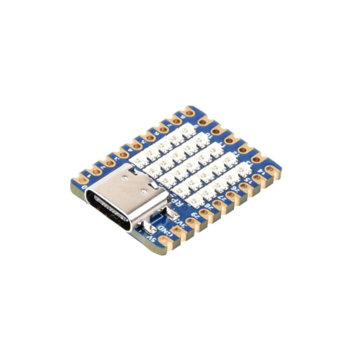

Waveshare RP2040-Matrix Development Board, Onboard 5×5 RGB LED Matrix, Based On Official RP2040 Dual Core Processor
RP2040 RGB LED Matrix Board
a Pico-like MCU board based on Raspberry Pi RP2040
Castellated module, suitable for SMD applications
Board specifications
  • RP2040 microcontroller chip designed by Raspberry Pi in the United Kingdom
  • Dual-core Arm Cortex M0+ processor, flexible clock running up to 133 MHz
  • 264KB of SRAM, and 2MB of on-board Flash memory
  • Onboard 5 × 5 RGB LED matrix for colorful lighting display
  • Castellated module allows soldering direct to carrier boards
  • USB 1.1 with device and host support
  • Low-power sleep and dormant modes
  • Drag-and-drop programming using mass storage over USB
  • 20 × multi-function GPIO pins
  • 2 × SPI, 2 × I2C, 2 × UART, 4 × 12-bit ADC, 16 × controllable PWM channels
  • Accurate clock and timer on-chip
  • Temperature sensor
  • Accelerated floating-point libraries on-chip
  • 8 × Programmable I/O (PIO) state machines for custom peripheral support
Dual-core Arm processor
supports C/C++, MicroPython, Arduino
Comprehensive SDK, dev resources, tutorials to help you easily get started
configurable pin function, allows flexible development and integration
What's On Board
  1. USB Type-C connector
  2. 5×5 RGB LED Matrix
  3. BOOT button
    press it when resetting to enter download mode
  4. RESET button
  1. RT9013-33GB
    500mA low dropout, low noise, ultra-fast LDO
  2. W25Q16JVUXIQ
    2MB NOR-Flash
  3. RP2040
    dual-core processor, up to 133MHz operating frequency
