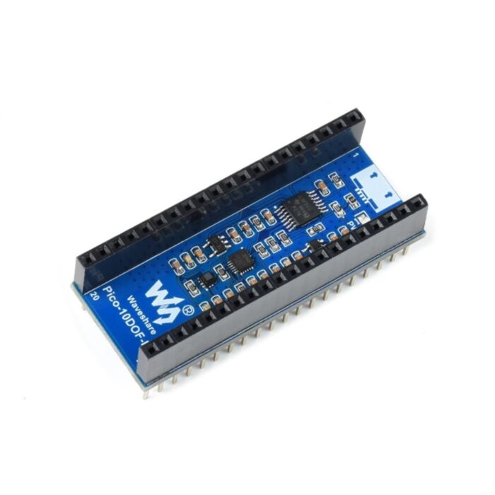

The Pico-10DOF-IMU is an IMU sensor expansion module specialised for Raspberry Pi Pico. It includes a gyroscope, accelerometer, magnetometer, baroceptor, and uses I2C bus for communication.
Combined with the Raspberry Pi Pico, it can be used to collect environment sensing data such as barometric pressure, or to easily DIY a robot that detects motion gesture and orientation.
  • Operating Voltage:
    • 5V
  • Accelerometer:
    • Resolution: 16-bit
    • Measuring range (configurable): ±2g, ±4g, ±8g, ±16g
    • Operating current: 450µA
  • Gyroscope:
    • Measuring range (configurable): ±250°/sec, ±500°/sec, ±1000°/sec, ±2000°/sec
    • Operating current: 3.2mA
  • Magnetometer:
    • Resolution: 14-bit
    • Measuring range: ±4900µT
    • Operating current: 280µA
  • Baroceptor:
    • Measuring range: 260 - 1260hPa
    • Measuring accuracy (ordinary temperature): ±0.025hPa
    • Measuring speed: 1Hz to 75Hz
What's On Board
  1. ICM20948 - 9-axis motion sensor, I2C bus
  2. LPS22HB - barometric pressure sensor, I2C bus
  3. RT9193-33 - 3.3V linear voltage regulator
  4. Power indicator
  5. Raspberry Pi Pico header - for attaching to Raspberry Pi Pico, stackable design
