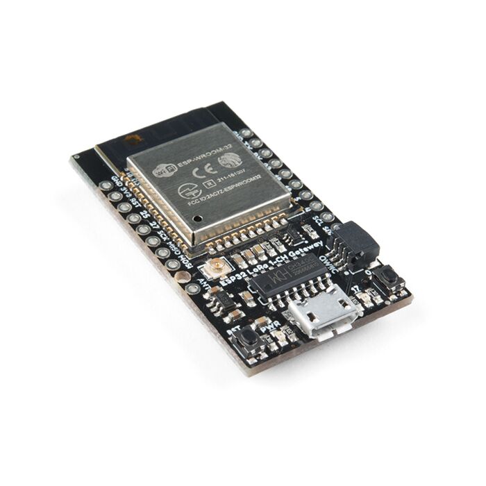

The ESP32 LoRa 1-CH Gateway combines an ESP32 – a programmable microcontroller featuring both WiFi and Bluetooth radios – with an RFM95W LoRa transceiver to create a single-channel LoRa gateway. It’s a perfect, low-cost tool for monitoring a dozen-or-so LoRa devices, and relaying their messages up to the cloud.
Complete with a Qwiic connector and a breadboard-compatible array of ESP32 pin-breakouts, this board can can also serve as a general-purpose ESP32/RFM95W development platform. So, instead of using it as a LoRaWAN gateway, you can turn it into a LoRa device, and use the powerful ESP32 microcontroller to monitor sensors, host a web server, run a display or more.
These boards are a great way to begin dipping your toes into the world of LoRa and LoRaWAN. Not only can they be programmed as a versatile single-channel gateway, but they can also be used as a LoRa device or a general ESP32/RFM95W development board.
For more information, check out our ESP32 LoRa 1-CH Gateway, LoRaWAN, and the Things Network tutorial, which explains how to set the board up, and get it connected to The Things Network.
  • ESP32-WROOM-32 module
    • WiFi, BT BLE microcontroller
    • Integrated PCB antenna
  • Hope RFM95W LoRa modem
    • Frequency range: 868/915 MHz
    • Spread factor: 6-12
    • SPI control interface
  • U.FL antenna connector for LoRa radio
  • Reset and ESP32 pin0 buttons
  • 14 GPIO ESP32 pin-breakouts
  • Power and user LEDs
  • Qwiic connector
  • CH340C USB-to-Serial interface
  • Micro-B USB connector for power and programming
