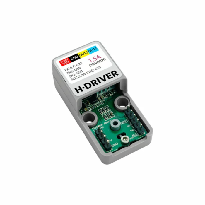

The ATOMIC H-Bridge Motor Driver revolutionises DC motor control with its compact design and robust feature set. This sophisticated 24V/1.5A motor controller integrates seamlessly with ATOM series controllers, providing precise bidirectional motor control with built-in protection circuits for reliable operation in both prototype development and educational environments.
Key Features
  • High-performance DRV8876 motor driver chip supporting 9-24V DC power input
  • 1.5A continuous output current with 2A peak capacity
  • Real-time voltage monitoring through ADC pin G33
  • Comprehensive protection suite including undervoltage lockout, overcurrent, and thermal protection
  • Integrated DC/DC circuit for efficient power management
  • 3.3V logic level compatibility
  • EMI reduction through spread spectrum clock technology
How to Use
Implementation of the ATOMIC H-Bridge Motor Driver is straightforward. Connect your DC power supply (9-24V) to the VH3.96-4P connector - we recommend the Core Electronics 24V DC 5A Fixed 2.1mm Tip Power Supply for reliable operation. The driver interfaces directly with ATOM series controllers through the built-in pins, enabling immediate motor control through standard programming interfaces.
For more advanced applications requiring higher power handling, consider the Sparkfun L298N Full-Bridge Motor Driver which supports up to 46V and 4A total current.
Technical Specifications
  • Input Voltage Range: 9-24V DC
  • Output Current: 1.5A continuous, 2A peak
  • Dimensions: 48 x 24 x 17.5mm
  • Weight: 15.7g
  • Protection Features: UVLO, CPUV, OCP, TSD
What's in the Box
  • 1x ATOMIC H-Bridge Motor Driver Base
  • 1x VH3.96-4P connector
Compatibility
Designed specifically for integration with ATOM series controllers, this H-bridge driver provides optimal performance when paired with DC motors operating within the 9-24V range. The 3.3V logic level compatibility ensures seamless integration with modern microcontrollers and development boards.
