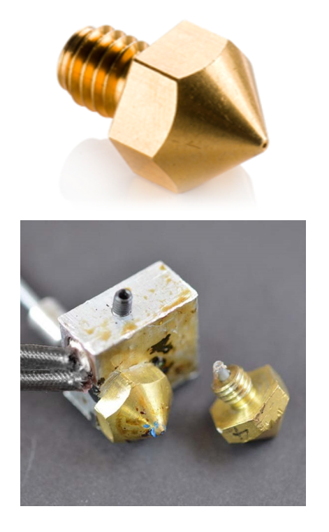

All 3D printers utilize print nozzles to heat and extrude material onto the build plate. The nozzle diameter directly affects the extrusion diameter of each line in a 3D print and directly determines layer height. They are crucial to successful prints and should be under the magnifying glass if grinding is occurring on your printer. The most common standard nozzle sizes for most 3D printers is 0.4mm. It makes for a great all-rounder, a good middle ground between speed and quality. However, it does not take much for it to become partially or fully blocked due to the tiny exit hole. Also, as the filament is abrasive the print nozzle is a wearing part and could be at the end of their lifespan. Check out Ultimaker Print Nozzles Overview and Installation to learn more.
Any manner of contaminant can cause blockages. They can come from the outside environment or from impurities in the filament. Blockages also occur if the filament is burnt when the print nozzle is set too hot or if there is the residue of the previous filament which has a higher melting point than what you are currently employing. Blockages cause higher stress on the 3D printing system as it tries to extrude the filament. This will eventually lead to filament grinding.
Furthermore, when it comes to nozzles it is important that the build platform is calibrated correctly. If the build platform is too close to the tip of the print nozzle it can create undue pressure on the feeder as it takes more work to get the material out. Here is a guide for the Ultimaker 3D Printer Build Platform Calibration. Also, settings can be altered inside your Slicing program to directly address the initial squish. Check out Printing Perfect First Layer Ultimaker Cura guide to learn more.
Putting on your deerstalker, if the extruder motor is pushing a thin amount of material out of the nozzle or if the extruded material curls heavily the second it comes out of the nozzle, it is indicative of a blocked nozzle. See the image below for examples. Also, blockages can sometimes be seen visually. Below are several nozzle cleaning procedures. The cleansing methods get progressively more extreme the lower you go.
