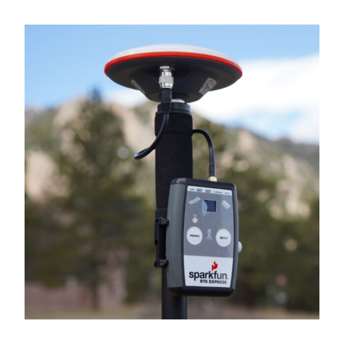

The SPK6618H is the latest advancement in GNSS antenna technology allowing tri-band (L1/L2/L5) reception for GPS, GLONASS, Galileo, and BeiDou constellations. These 'UFO' antennas have incredible performance for the money. The antenna has a built in ground plane with significant filtering and amplification of both L1, L2, and L5 frequencies for all GPS, GLONASS, Galileo, and BeiDou satellites. Excellent for surveying or fixed antenna applications.
For automobile applications please see our u-blox ANN-MB-00 GNSS antenna. For weight sensitive applications (like RTK Drones) checkout the BT-560 helical GNSS antenna.
Designed for the latest u-blox F9 platform it provides a fast, easy, and reliable multi-band antenna solution but can be used with any GPS/GNSS receiver that can benefit from the L1/L2 dual or L1/L2/L5 triband reception. While this antenna works great with normal L1 GPS/GNSS receivers it will not make your $20 receiver into a $200 receiver. Please check your receiver to verify it is capable of using the L1 and L2 signals that this antenna outputs. If your receiver is not compatible with L5, that is ok too, there is no harm using this tri-band antenna.
We disassembled a unit because Sparkfun love to see how things work! The antenna incorporates a 130mm ground plane with six hybrid couplers to obtain signal phasing which makes this design a lot more insensitive to manufacturing-imposed issues (e.g. board material with inconsistent dielectric).
It is important that you are also aware of the unique connection points on this antenna as the data and mounting connectors may be new to some users. This antenna has a TNC female connector found on nearly all surveying antennas. Sparkfun recommend a TNC Male to SMA adapter or cable when using with our GNSS receivers. Also, this antenna uses a standard 5/8"-11TPI (threads per inch) connector found on surveying equipment. This is not compatible with a camera tripod. Sparkfun recommend a 5/8" to 1/4" tripod adapter. You can also find 5/8"-11TPI threaded rod in most hardware stores in North America. For information about permanently fixing this antenna to a roof, please see our tutorial on How to Build a DIY GNSS Reference Station.
