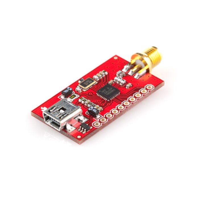

This is a breakout board for Nordic’s nRF24LU1+ system-on-chip wireless transceiver. The nRF24LU1+ features a fully integrated USB 2.0 compliant device controller, which allows for a very compact wireless USB dongle. The nRF24LU1+ is compatible with our nRF24L01+ 2.4GHz RF transceivers as well. Additional features include an 8-bit application microcontroller, 32 kB flash memory, 6 GPIO pins, SPI and UART support, and up to 2Mbps on air data rates.
This breakout board includes all parts as shown in the pictures. The included antenna connector is an RP-SMA, see the related items below for compatible antennas. The board also includes a 3.3VDC voltage regulator, and all necessary supporting components. A mini-B USB connector is also populated on the board, allowing you to take full advantage of the nRF24LU1+’s USB 2.0 support.
