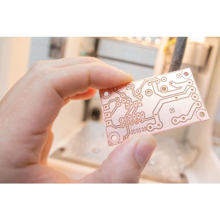

The above photo is copyright by DIYODE Magazine, who use a Bantam Tools PCB Milling Machine as well!
