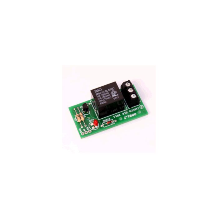

Many people asked if we did a "normal" style relay, a version that required just a single "data" line to turn on/off.  So we designed this.
You need 3v to power the relay coil (2.8v to 4v will do). The input (IN) requires just a few milliamps at anywhere between 2.5v and 12v. You can even use the same volatge you are powering the coil from.
  • Low cost way to control larger voltages and currents.
  • Relay supplied will vary depending on stock; will either be a 7A or 10A device.
  • Supplied as a kit. Easy to build.
  • Supports any microcontroller or TTL signal (3.3ma drive max) 3.3v to 5v supported. Relay current consumption at 5v is 73ma (on the IMO relay pictured)
  • On-board switching transistor.
  • On-board back EMF protection.
  • Easy 1 wire drive. High for on, low for off.
  • Small size 50mm long x 26mm wide x 19mm high
  • mains rated relay
