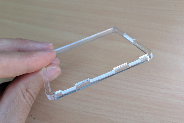

Once the paper is removed locate the small panel with the engraved notches. Be careful not to bend this layer as it is fragile until the case is assembled.
Thin layer of Slim Case for 3A+
