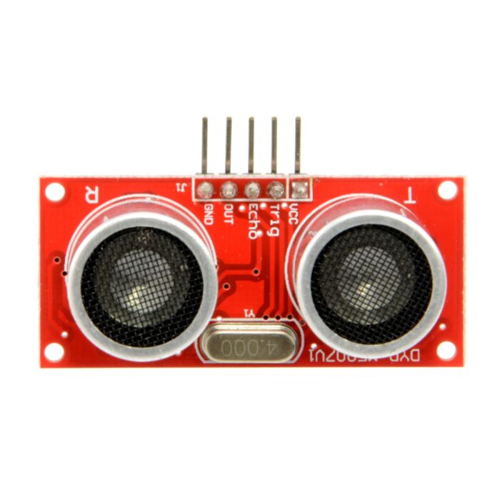

Non-contact Ultrasonic Motion / Distance Sensor Module
SKU: 017-MB-SM19114 Brand: Sure Electronics
This item is a high performance, cost-effective ,non-contact distance measurement module, and with temperature compensation;is calculated by distance by 340 m / sec; measuring range of 0.02 to 5.00m, accuracy 1cm, measured with the measured object without direct contact, can clearly show a stable measurement result.

A short ultrasonic pulse is transmitted at the time 0, reflected by an object. The senor receives this signal and converts it to an electric signal. The next pulse can be transmitted  when  the  echo  is  faded  away.  This  time  period  is  called  cycle  period.  The  recommend  cycle period should be no less than 150ms.
If  a  10μs  width  trigger  pulse  is  sent  to  the  signal  pin,  the  Ultrasonic  module  will  output eight 40kHz ultrasonic signal  and detect the echo back. The measured distance is  proportional  to  the  echo  pulse  width  and  can  be  calculated  by  the  formula  above.  If  no obstacle is detected, the output pin will give a 65ms high level signal.

  • Size: 46mm(L) * 21mm(W) * 15mm(H)  ± 0.2mm
  • Small size, easy to use
  • Low voltage, low power consumption
  • Wide measurement range and high accuracy
  • With temperature compensation
