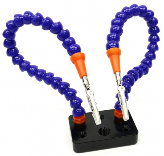

  • Hobby Creek Mini Hand: Having something to hold what you’re working on is a must. When soldering you’re holding the iron in one hand, solder in the other, and soldering to a loose board sitting on your desk isn’t fun. Check out its big brother the Third Hand as well.

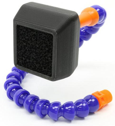

  • Hobby Creek Fume Extractor: Even if you’re soldering with lead-free solder, soldering still gives off a small amount of fumes and smoke which most people would rather avoid inhaling. This USB powered fume extractor screws into your existing Hobby Creek base and is perfect for creating a clean workstation.

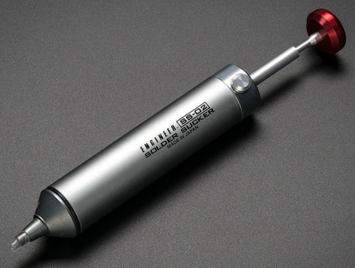

  • De-soldering Pump: As we’ll look into in a separate article, often you’ll need to de-solder something, be it a misplaced component, or excess solder causing a bridge. A quality de-soldering pump goes a long way.
