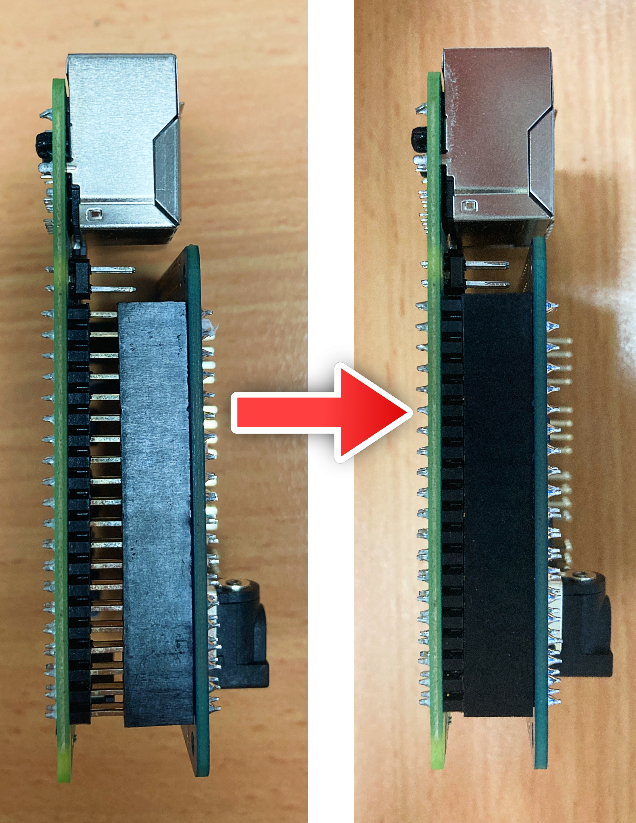

To start, attach the Hat to the top of the Raspberry Pi by lining up the headers of the HAT with the GPIO pins of the Raspberry Pi. See this happening in the image below. Take care that all the pins are correctly lined up and that the HAT is fully seated.
Connecting up the HAT to the Raspberry Pi- Make sure to line up the GPIO Correct

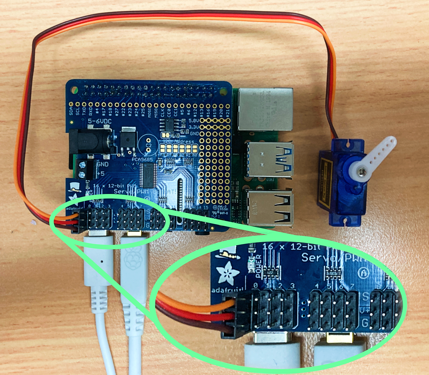

With that complete attach the desired Servos to the HAT. Take careful note to connect them correctly. The ground pin side on the HAT is the one closest to the edge of the board. Black or Dark Brown is the normal colour for ground wires on Servos. Red is the normal colour for Positive Wires on Servos. The Data wire which tells the direction/speed/angle of the Servo the go-to is normally an Orange or White colour. Below shows an image of a single servo correctly connected onto the 0 port of the Servo HAT. In code, we will refer and identify the ports by these numbers.
Showing a single Servo connected perfectly in port 0

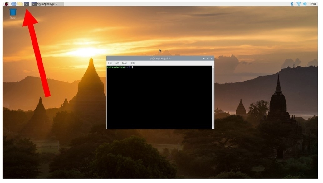

Now with your system rebooted and connected to the internet, open a new terminal window by pressing the black button on the top left of the screen. This will open up a terminal window. See the image below of this happening and a big red arrow pointing towards the terminal button that was pressed.
Terminal console Location
This terminal window will enable us to download from the internet the exact packages we require. So now type and enter the following lines into the terminal to get all the packages that you will need. If prompted, type and enter | Y | to continue/confirm installations. See above video to watch these commands being downloaded.

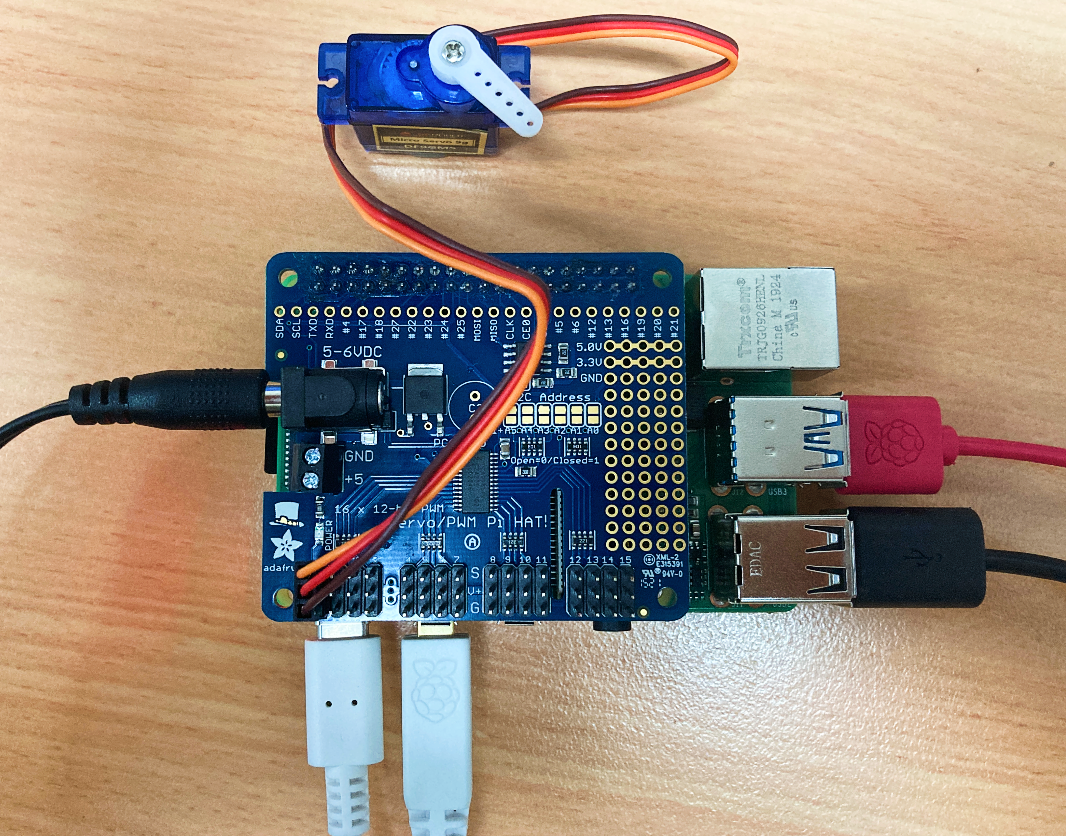

Below is a simple code that will run a single standard servo that has been attached to the 0 connector point. If you have connected it to spot 5 you would alter any instance of | kit.servo[0] | to | kit.servo[5] |. See the image of the setup further below. You can copy and paste this into either Thonny or Geany (both are just Python Language Interpreter Software) save it and then run it. You can also download this script at the bottom of this page, name of the script is | Basic-Servo-Control.py |.

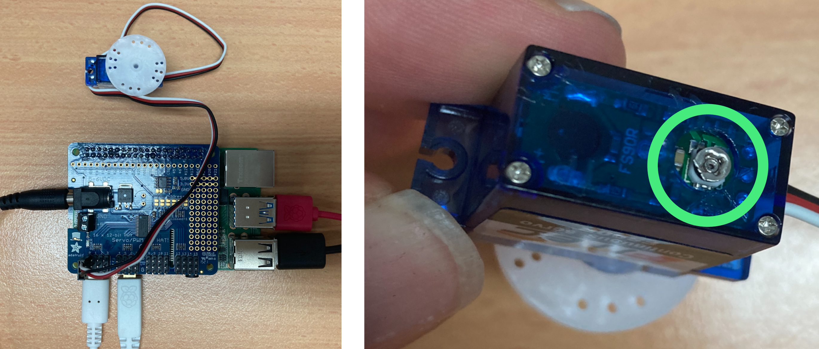

Below is the simple code that will run a continuous servo using this Adafruit HAT. You can copy and paste this into either Thonny or Geany (both are just Python Language Interpreter Software) save it and then run it. You can also download this script at the bottom of this page, name of the script is | Basic-Servo-Continuous-Control.py |. As a note, if you find it running when you have set the throttle to 0 the best way to fix the problem is to adjust the Potentiometer with a screwdriver (found on the bottom of most common servos). Rotate the potentiometer with the throttle set at 0 and adjust until the continuous servo stops rotating. At that point, it will be correctly dialed in. See the continuous servo and the underneath of the continuous servo highlighting that potentiometer in the image below.

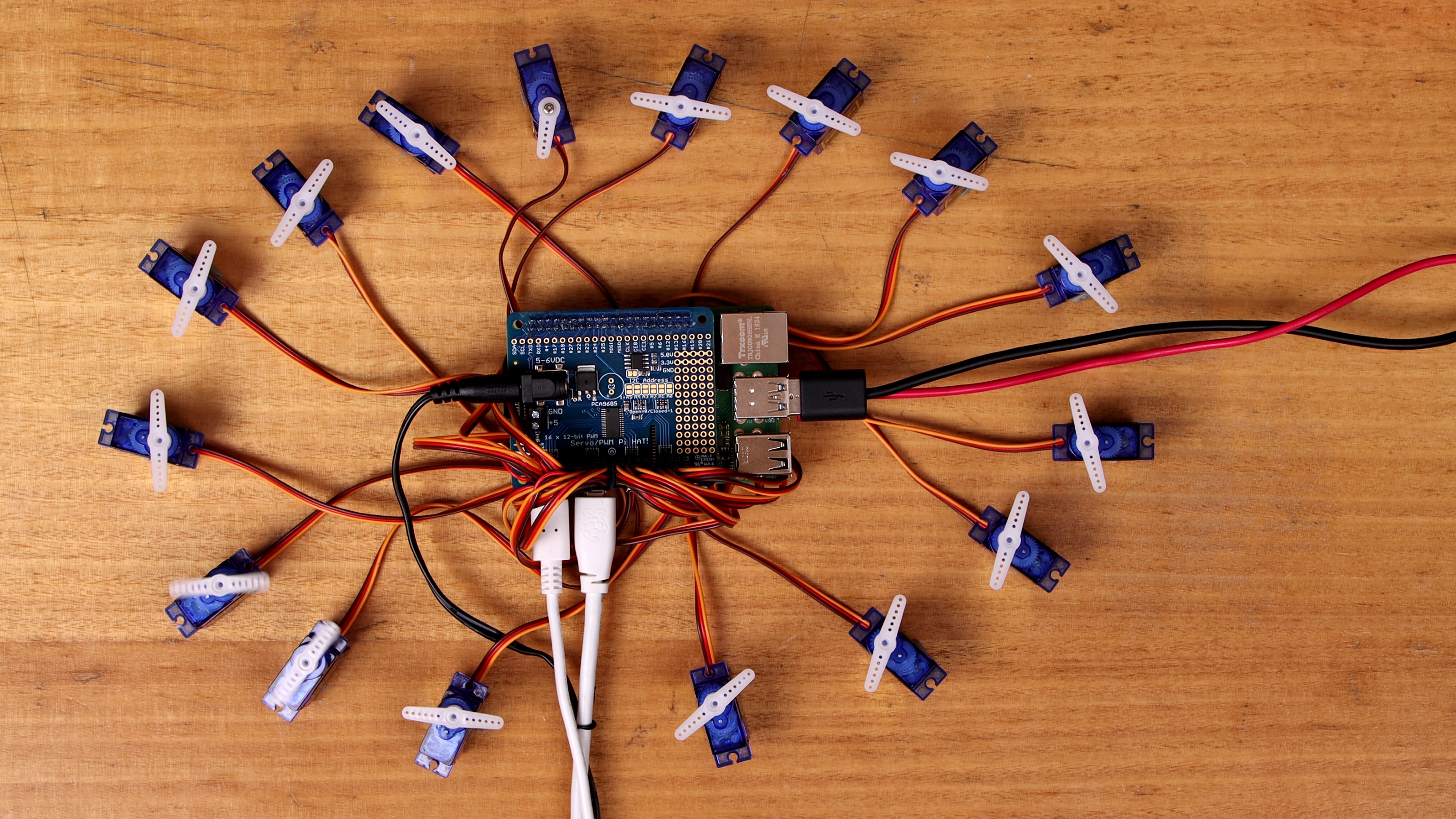

Let's get crazy with this and control All the Servos all the time! See the script to do this below. Jumping into the script you can see I have just expanded on the previous to send out PWM signals through each port with a 0.2-second delay between each movement. You can copy and paste below into either Thonny or Geany (both are just Python Language Interpreter Software) save it and then run it. You can also download this script at the bottom of this page, name of the script is | Max-Servo-Control.py |. This will use every single PWM signal that this HAT can produce to control 16 different servos independently. Check the image directly below for this all set up.

Now I just need 61 more Adafruit 16 Channel HATS and 976 more 5V Servos and we can max this baby out!
