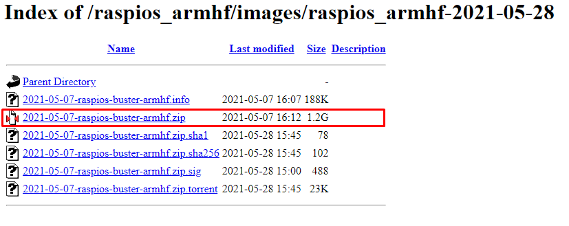

The next step is to get the original 'Buster' Image file onto your computer. Navigate to the official download repository for Buster OS. All earlier versions of Raspberry Pi OS can be found and downloaded here and the directly previous Raspberry Pi 'Buster' OS official download link is here. See below for what that looks like, download the image file by clicking on the highlighted file.
Raspberry Pi Image Download Location Highlighted in Red

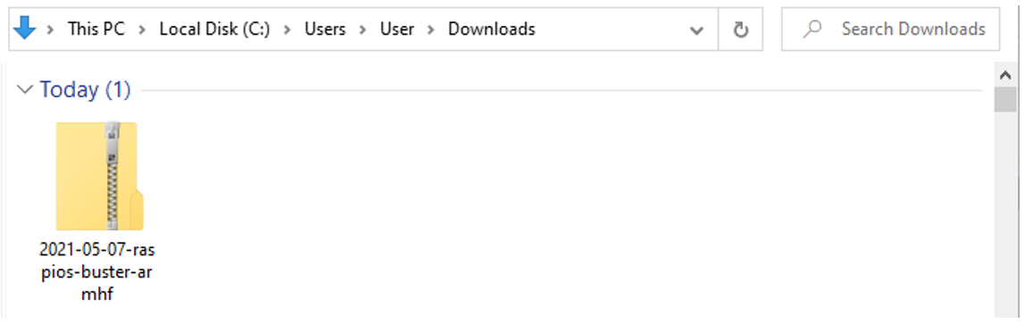

Find this downloaded file in your file explorer. See this in the image below.
Here is the downloaded file

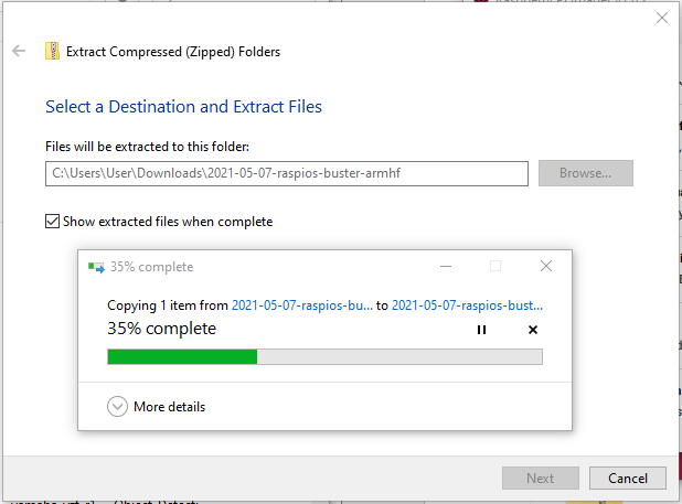

Right-click this file and choose to extract it. This process of unzipping the file will take less than 2 minutes. See this happening in the image below.
Unzipping the Image file

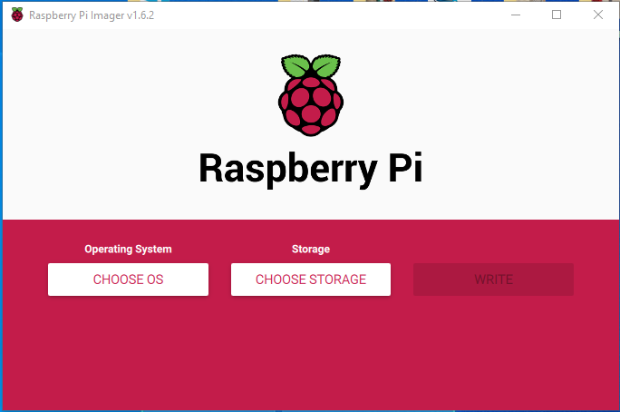

We now have the image file of the previous 'Buster' OS on our computer. Now, let's open up the Official Raspberry Pi Imager, see it in the image below. Worth noting here - if you hit | CTRL+SHIFT+X | on your keyboard while in the Raspberry Pi Imager Program it will open the Advanced Hidden Menu. This Hidden Menu allows you to preconfigure your Raspberry Pi with SSH, WIFI credentials, and Localisation settings.

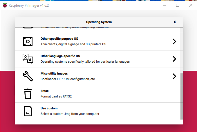

With the Official Raspberry Pi Imager open, click on the | CHOOSE OS | button and scroll, using your mouse wheel, all the way to the bottom of the menu to where you can see the | Use custom | option, see this in the image below. You will want to click this option.
Choose Custom Image

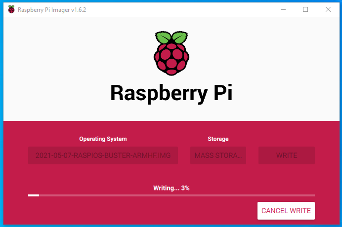

With everything sorted (the right OS loaded and the correct Storage selected) you can now click the | WRITE | button to start the flashing process. See this flashing process in the image below.
Flashing Process undergoing
