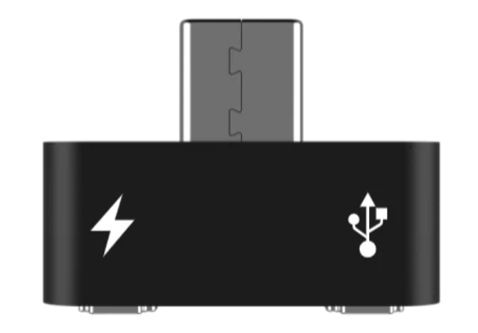

As a note here, it is possible to use a USB-C Power/Data Compatible Splitter (OAK Y-Adapter) on the OAK-D Lite side. This means you will be able to power the OAK-D Lite directly. You may want to do this if you are running power/computationally intensive programs on your Raspberry Pi Single Board Computer. Examples of computationally intensive functions would be ones that use inference or have video encoding as these can cause large current spikes when run. You may want to do this also if you are using the OAK-D Lite with an earlier Raspberry Pi Single Board computer that doesn't have the higher watt USB3.0 outputs or are powering multiple devices from the Raspberry Pi. In these cases, you would want to use an external power adapter for the OAK-D Lite.
Oak-D SplitterThen with that completed turn on the system by putting power into the USB-C 3.0 port of the Raspberry Pi Single Board Computer by using a USB-C Power Supply. Also, note I've 3D printed a protective case for the OAK-D Lite out of Ultimaker TPU 95A which you can find the 3D print files for it here, all credit goes to YANG_GT.  See the image below for the complete hardware assembly.

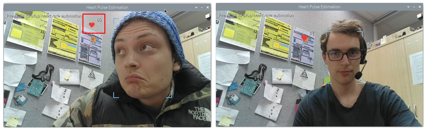

We are also going to monitor our heartbeat remotely with a camera! This means we no longer need to wear Apple watches or have wires/sensors attached to our skin to know this information. We can just be under camera vision and see our heartbeat fluctuate in response.
Open up a Sudo Thonny IDE and open up the | main.py | python script in the same way as before. Importantly you can find it under the directory | home/pi/heartrate_estimation-main/heartrate_estimation-main/ |. We will need to alter two lines in the setup. Comment out line | colorCam.initialControl.setManualFocus(130) | by typing a| # |infront of the line. Thus the altered line will look like | #colorCam.initialControl.setManualFocus(130) |. Also understand that the most powerful lever we have is the Pixel Threshold Value. Use a value between | 1.5 | and | 2 |. This will help us get more accurate results and accommodate for environments with different lighting.
Editing the Python Code
Then with those additions run it by pressing the big green run button as normal. A Video Preview window will open up just like below. It will start tracking human faces. Press | S | on your keyboard with that Preview window selected and Heart Rate Estimation will start. Check the image below to see the system running. You will also notice my initially suspicious face looking at the data. Superstar Trent from our phenomenal Core Electronics Support Team happened to be wearing an Apple Watch. So I brought him over for a quick test to confirm the results were within the right ballpark and it was! Accurate to a range of around +-5 BPM.
The way this system works is as follows. It starts by focusing and locking onto a human face. It Then hyper focuses on the forehead of that human face. It then uses Edge Detection image manipulation software (which you can see in the image below) to hyper-exaggerate colour/edge changes. This then means it can pick up on the ultra subtle pumps of the veins in the forehead. It then uses a machine-learned system to identify these changes, which occur at the same rate as your heartbeat to determine your BPM. Bonkers!
Very Kindly Trent allowed me to use these photos of him. Im sure the community appreciates a more normally sized forehead for a change.
This seems like a Perfect System for Baby Monitoring, one that doesn't require any wires attached to the infant yet can provide all the positive signs of life data that you would want to have 24/7.
