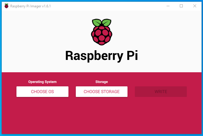

Once installed and opened it will look like the image below.

This will be best explained using as many image as possible. Thus that is exactly what this section will look like. Start by selecting the Raspberry Pi OS as your desired Operating System (OS). Click the |CHOOSE OS| to do just this. See this in the image below.
