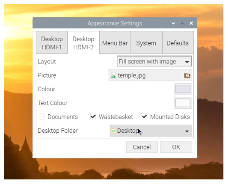

The first window worth looking at is the Appearance Settings which is seen below. This window can be found by right-clicking anywhere on the desktop and then click on Desktop Preferences in the menu toolbar that opens up right next to curser. There are two tabs that let you alter the settings for each monitor. Taskbar tab lets you decide which monitor will have the taskbar on it.
The checkboxes can be used on the bottom of the desktop tab to automatically show all the application icons within that folder of your Raspberry Pi to the specific desktop.
Apperence Setting Windows

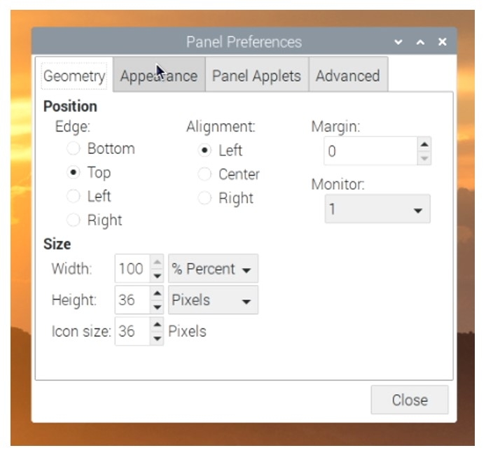

The final customisable window you can access is Panel Settings which is seen below. Now if you go to the top taskbar and right-click on it and hover your mouse inside the menu bar down to the options panel preference. Clicking on this opens up the program to the right called panel preferences.
Going to the Monitor tab and clicking on that will allow you to decide whether the top toolbar exists on only one monitor or if it stretches all the way along the length by selecting All.
Panel Preferences
