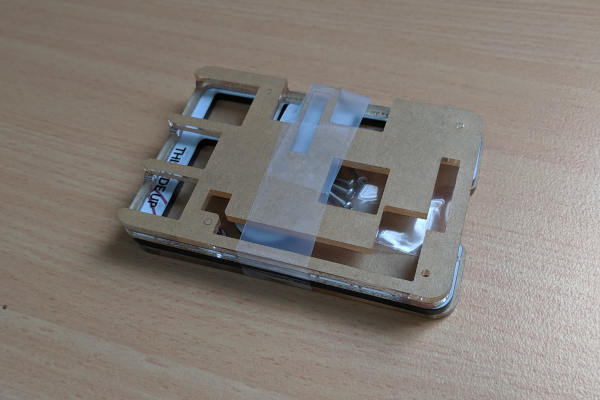

Unwrap
When you receive your case it will come with all the panels protected with paper, and the parts enclosed inside. The first step is to remove the paper from all the panels. We've included an acrylic scraper to help get the paper started and save your fingernails. This also helps remove the little bits that will be around the engraved text on the top panel. Just slide the flat edge of the scraper across the text to remove all the little paper parts! The acrylic scraper is unlikely to scratch the panel if you don't press too hard.
First Layer
Once the paper is removed locate the small panel with the engraved notches. Be careful not to bend this layer as it is fragile until the case is assembled.
Position your 3B+ inside this layer by pressing the Pi in from the top. The bottom edge of the acrylic layer and the bottom edge of the Pi should line up. The notches should line up with the connectors on the Pi to allow it to sit flush.
Black Layer
Position the black layer on the bottom of the board. This layer will sit so the SD card can still be accessed and the panel will not rest on any components. The "thick" side will be near the GPIOs. See the photos below.
Bottom Layer
Place the bottom layer in position. The engravings for the nuts should face out, and the notch should face the microSD card slot.
Position Top Layer
Rest the top layer in position
Screw in the Panels
Put the screws through the holes from the top.
Press the nuts into the recesses on the bottom panel. Then lightly tighten the screws. They do not need to be very tight!
Complete!
Enjoy your new case!
