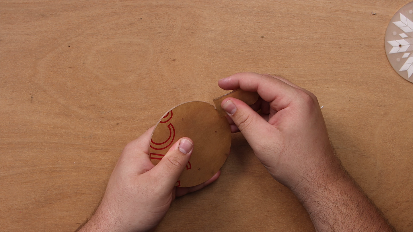

To start, pick a diffuser you like and peel the protective paper off the front. Fingernails can help with this, or you can use the included scraper to help make a start. These acrylic sheets can scratch easily, so avoid using anything metal on them.
Once the protective layer is removed, use the four standoffs and eight screws to mount the plate to the top of the GlowBit Orb, like in the image on the right.

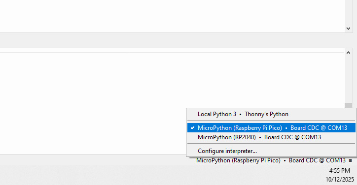

Once Thonny is installed, connect your Pico to your computer. In the bottom right corner of the Thonny window, you should see the Pico appear as a connected device.
After selecting your Pico's COM port in this section, go to View → Files to see all the code stored on the device. Here you’ll find files like orb_extensions, glowbit.py, and petme128.py. You can ignore these as they’re part of the libraries that help control the LEDs. What we’re interested in is the main.py file. This is the file that runs automatically whenever the orb is powered on.
