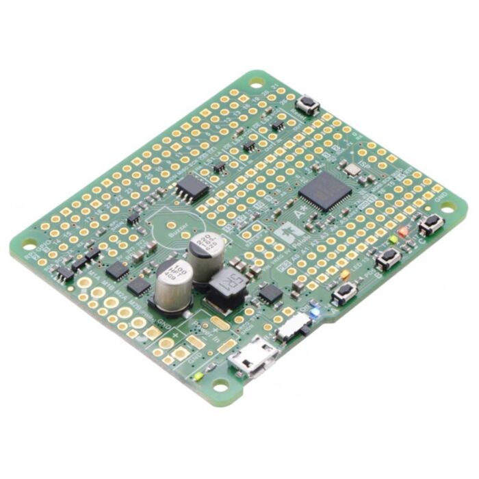

A-Star 32U4 Robot Controller SV with Raspberry Pi Bridge (SMT components only).
This version of the A-Star 32U4 Robot Controller SV with Raspberry Pi Bridge (5.5 V to 36 V input voltage) does not include any through-hole components. It ships as shown in the picture above, without any male or female headers, terminal blocks, DC power jack, buzzer, or Raspberry Pi mounting hardware. This configuration is intended for those who want to use the board as a standalone robot controller or customize the way it is assembled for use with a Raspberry Pi, such as by installing a stackable 2×20-pin female header in order to continue to have access to the Raspberry Pi’s 40 GPIO pins while the A-Star is plugged in. If you want to use this version with the Raspberry Pi, Pololu recommend you also get 11 mm M2.5 standoffs along with compatible nuts and screws.

A-Star 32U4 Robot Controller SV 5 V regulator
A major feature of the A* Robot Controller SV is its power system, which allows it to efficiently operate from a 5.5 V to 36 V external source and provide power to an attached Raspberry Pi. The input voltage is regulated to 5 V by an MP4423H switching step-down (buck) converter from Monolithic Power Systems. (We also make a standalone regulator based on this integrated circuit.)
As shown in the left graph below, the SV’s 5 V switching regulator has an efficiency – defined as (Power out)/(Power in) – of 80% to 95% for most combinations of input voltage and load.
The A-Star’s components, including the microcontroller and LEDs, draw 30 mA to 40 mA in typical applications (without the buzzer). The rest of the regulator’s achievable output current, which depends on input voltage as well as ambient conditions, can be used to power other devices; this can include an attached Raspberry Pi (which typically draws a few hundred milliamps). The green line in the right graph above shows the output currents where the regulator’s output voltage drops below 4.75 V. These currents are close to the limits of the regulator’s capability and generally cannot be sustained for long periods; under typical operating conditions, a safe limit for the maximum continuous regulator output current is 60% to 70% of the values shown in the graph.
The dropout voltage of a step-down regulator is defined as the minimum amount by which the input voltage must exceed the regulator’s target output voltage in order to assure the target output can be achieved. As can be seen in the graph below, the dropout voltage of the Robot Controller SV’s regulator increases approximately linearly with the output current. For light loads where the dropout voltage is small, the board can operate almost down to 5 V. However, for larger loads, the dropout voltage should be taken into consideration when selecting a power supply; operating above 6 V will ensure the full output current is available.
Note: Batteries can have much higher voltages than their nominal voltages when fully charged, so be careful with nominal voltages above 24 V. A 36 V battery is not appropriate for this product.
