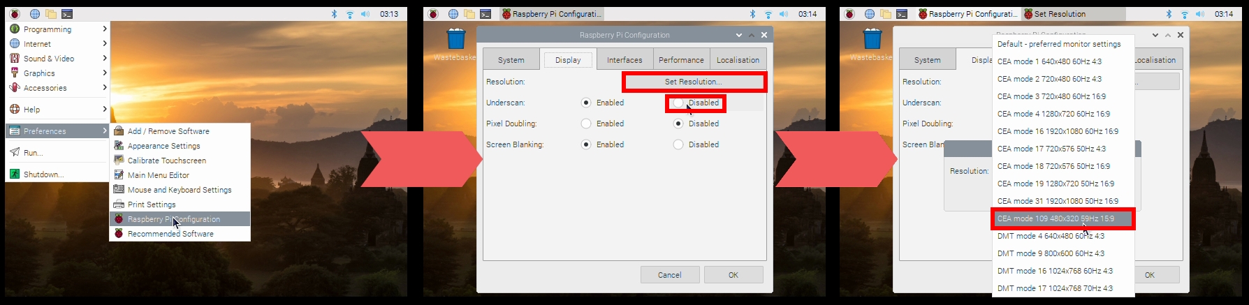

Getting the correct screen sizing on your little monitor is the next step. This Waveshare 3.5 Inch screen has a more uncommon 15:9 size ratio so it will not automatically go to the optimal size.
The fastest way to change this is to click the top left Tool-Bar Button (the one with the Raspberry Symbol on it), then clicking Preferences, and then clicking on the Raspberry Pi Configuration Button. With this open navigate to the Display tab, see image below for this. In this browser, you will see two important settings. First is Underscan. Set this to Disabled so that way no matter what your display will not have black borders. Next is Set Resolution. Click this and select your resolution, in this case for the Waveshare 3.5 Inch screen select the CEA mode 109 480x320 59Hz 15:9. See this setting highlighted in the image below. With that done run a restart and these settings will be locked in.
Setting the Screen Resolution

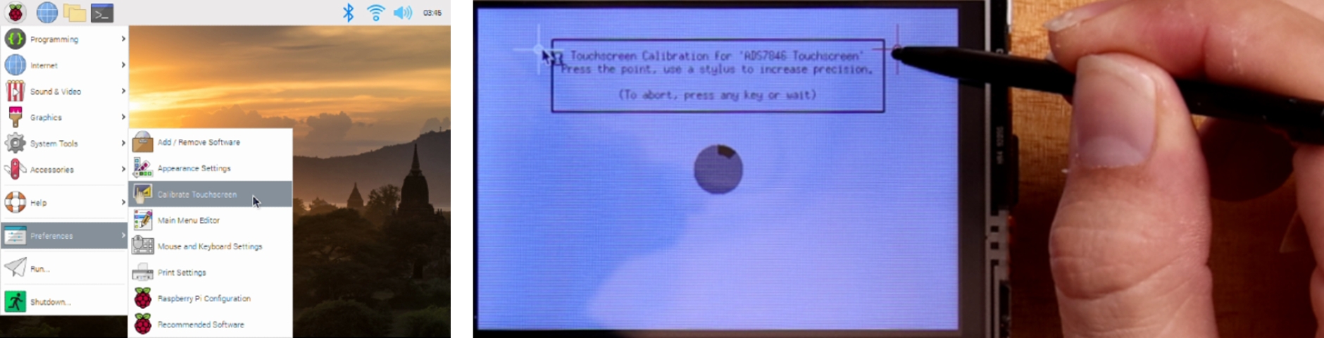

If you have a problem accurately selecting objects on your 3.5-inch touch screen that problem can quickly be rectified by running a touch calibration. First, we need to install the xinput-calibrator program which will allow us to run this application. Type and enter the following into a new terminal window to download this program.
sudo apt-get install xinput-calibrator
This will run a quick downloader. With that complete, you can then find this program by clicking on the top left Tool-Bar Button (which has a Raspberry Symbol on it), then clicking on Preferences and clicking on the Calibrate Touchscreen Button. This will run a quick wizard as you can see in the image below which when completed correctly will calibrate your screen. Calibrate it correctly by clicking in the middle of each subsequent red X as they appear. See the image below of this occurring.
Calibration time!
