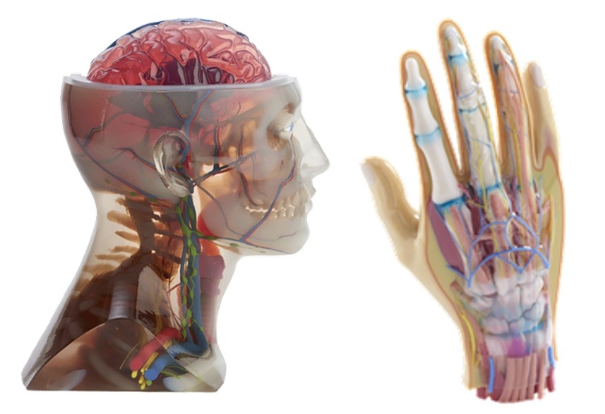

If money is no object and your sole interest is beautiful, coloured parts of the whole rainbow the best bet is from Material Jetting technology. The technology works similarly to traditional inkjet printing, but instead of jetting ink onto paper, a print head jets liquid photopolymers onto a build tray where each droplet cures in a flash of UV light. The PolyJet Multi-Color like the Stratasys J750 is the best set up currently for multi-coloured prints but it does require multiple post-processing steps with multiple propriety machines to improve both the strength and colour of the final piece. The final results do speak for themselves.
PolyPrints are out of this world!

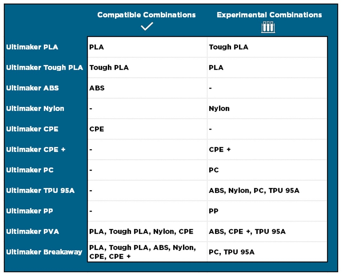

Back to Dual extruding with Fused filament fabrication. Now specific materials can bond well with some materials but not well with others. As dual-extrusion printing often occurs with different filament materials it is worthwhile to understand and know these relationships between them. For Ultimaker printers this dual-extrusion capability is found on Ultimaker S5 3D Printer and Ultimaker S3 3D Printer as standard. Below is a chart in relation to Ultimaker dual-extrusion printing, displaying compatible and experimental material combinations. Not all 3D printing machines are made equal but the information in the table below is generally applicable no matter what dual extruding 3D printer you have. Here is a link to a range 3D printing filament.
Compatible is the go!
3D printing filaments have a wide range of properties and successful prints employing multiple materials will be harder to achieve the more extreme the material properties differences. Printing two completely different materials is normally not good engineering practise as bonding between them will often be weak and inevitably produces poor prints. For the best success, it is crucial to know the interactions between different materials when utilizing dual-extrusion heads.

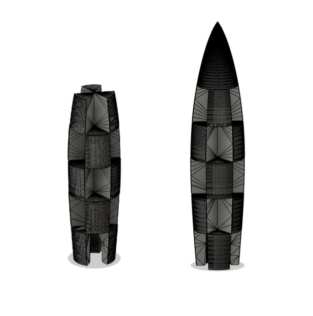

Each colour needs its own unique CAD model. This means you either need to design each colour as a unique part or separate a full-body into multiple parts. So keep this in mind when designing your parts. Below you can see two models which represent the Red part and the white part of the Rocket from The Adventures of Tintin. Jump to the Acknowledgment Section to find this model and print it yourself. It is by overlaying these two models in the slicing software and then slicing it like that which enable dual coloured printing with dual-extrusion to work correctly.
Tin Tin Rocket in Fusion 360. Left is the white section Right is the Red Section

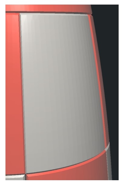

To increase the crispness between colour transitions, have a small relief or trench between sections when looking at the X or Y plane. In the Z plane ensure that there is no gap between colours and that they do not overlap (unless you want to mix the colours together which is possible, but this guide will focus on making sharp transitions between colours) and also have that trench. The trench is less than a millimetre deep and imperceptible from a distance but makes a huge difference. Below is a close up of the rocket with the taper/trench visible between the section. It is subtle but makes a huge difference in the final result. Very much worth the effort.
Trench Between Colours

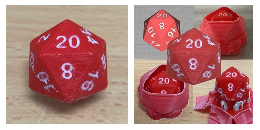

Most important is to use a purge tower and an ooze shield. Using both in combination enable the best cleanest results. Both methods are techniques a 3D printer use to prime the printing nozzles for the next layer. Without either a purge tower or an ooze shield, you will end up with stringy hair-like filament covering your desired component and have blemishes on the surface. Purge towers are also referred to as prime towers and are an additional print created on the build plate made to the height of the component desired. Ooze shields are a one-layer wide wall that encase, but does not touch, the final model. For more information of these and the settings I use for them check out the tutorial Purge Towers and Ooze Shields.
Top of Rocket encased in Ooze shield with Prime Tower in back
Now to get the best results out of your 3D printer check out Improving your 3D printed models guide found here. Once you have found a profile and setting that crushes make sure to use that exact same set up for both print materials. This will enable consistent results across the model with matching layer lines. Ultimaker Profiles for PLA and ABS automatically work. Colour differences between the same filament would change the material properties but the effect is negligible. Also, minimise supports around surface areas. Support structures can mark the final surface and this will affect the final result. See below for some different angles of 3D printed d20 Dice. The sides which I used support have a worse surface finish than the side that did not need support. This dice also demonstrates the advantages of Dual colour surfaces on positive slopes and not on overhung sections. These had ooze shields and purge towers as well.
