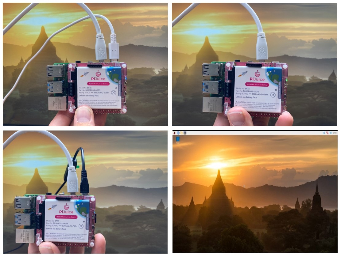

Below you can see an image of the system staying on when connected via USB-C, Micro-USB and even when there is nothing plugged in at all (emulating a Blackout). The battery life for a PiJuice is for 4-6 Hours in this scenario when it is not connected to the mains. As soon as it comes back it will start charging and continue supplying energy to the Raspberry Pi. Very nifty! Especially considering no software or code has been installed to the set up. Those Brits working at PiJuice have got it figured out.
All the different ways of giving and interrupting power

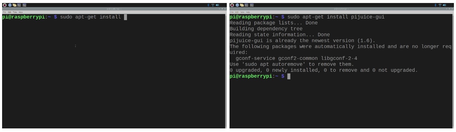

Once this is open we will type the following into the console. After each line of code, press enter on your keyboard to run it. This can be seen occurring in the image below on the left, make sure to type the spacebars too.
sudo apt-get install pijuice-gui
Then once that is complete, like the image below on the right, safely restart the system using the Raspberry button on the top left (the Top Toolbar Menu) and selecting Log Off on the dropdown menu.
Sudo Command being run successfully

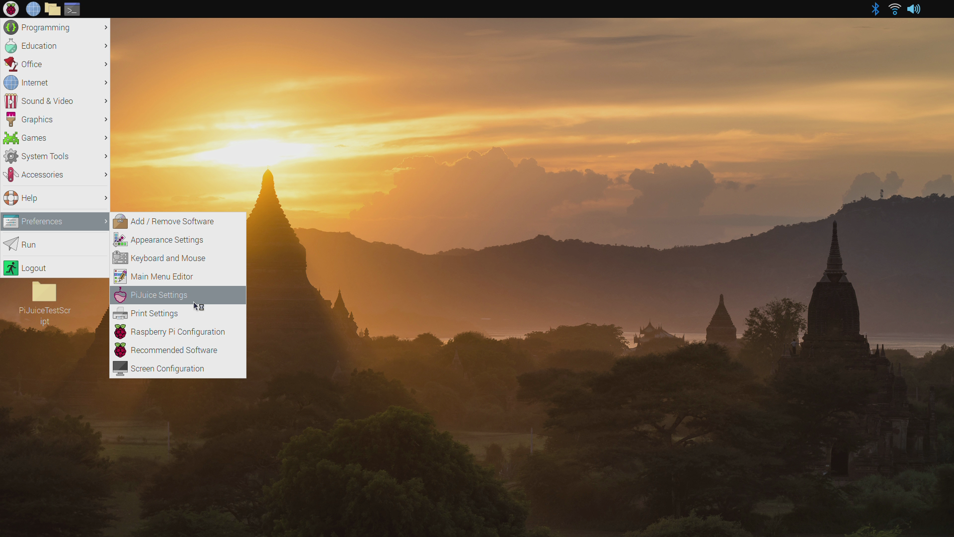

Then after a reboot, you will see a new Icon. Find it by clicking on that top-left Raspberry (the Top Toolbar Menu) and holding your mouse over Preferences. An image of this can see below. Definitely worth an explore.
Location of New Settings

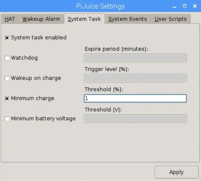

Clicking on this will open up a fantastic world of settings to adjust your UPS PiJuice Raspberry Pi 4 to your exact desire, definitely worth an explore. See below for this.
Setting Window for UPS
