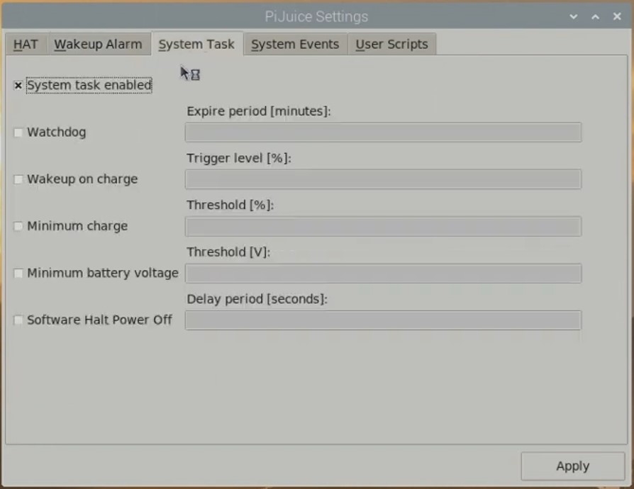

Clicking on one of these buttons to open up the PiJuice Settings Menu lets now set it up to switch off automatically once it gets to 10% power. This we can do in the System Task Tab, see the image below, by ticking the Minimum charge and then typing in 10 as the Threshold amount.
So if your devices ever goes underneath 10% of charge the system will turn itself off automatically. So if there is a day or two without sun or for whatever reason the Raspberry Pi will be able to shut down safely remotely. But say there was a sunny day and we wanted to have the system come back alive (for instance if this was a remotely set up birdwatching camera that we would only check on once a month) then we can incorporate a wakeup on charge. This is done in a similar manner by selecting the tick on the Wakeup on charge setting and then adding a trigger level, lets say for this at 90% it will turn itself back on. Then making sure to click Apply these settings are now locked in. Brilliant.

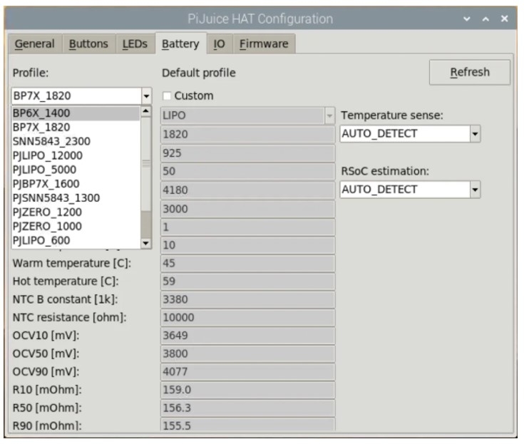

Also if you have installed a different battery take the time to change the battery profile so that you can have optimal functionality. This can be done in the PiJuice HAT Configuration Window and then navigating to the Battery Tab which you can see below.
This is a great guide to follow as it goes through the process of connecting the wires correctly and changing the battery profile which can be found in the PiJuice Settings. The following lithium polymer batteries sizes all have profiles already set up for PiJuice however you can easily create custom profiles to suit different battery sizes.

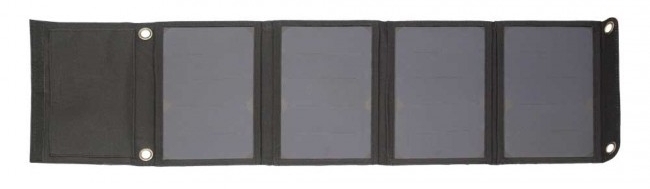

It is important to know that solar panels will work on cloudy days but will be less efficient than their max value and if they are not pointed directly at the sun they will decrease their efficiency further. PiJuice offers four different types of solar panels that retain the ease of use and only differ in Watt power, see below for a list of the available ones and an image of the PiJuice 22 Watt Solar Panel.
