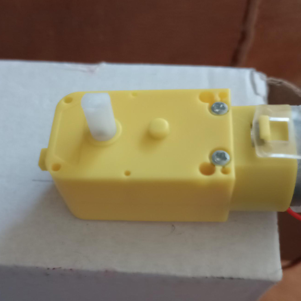

  2. Motor Holes: Make a big hole using a pencil.
  3. Place a motor onto the hole with the axle in the hole.
  4. Poke the LED through all the motor’s holes.
  5. Make the holes using a pencil, but they must only be the width of a cable tie.

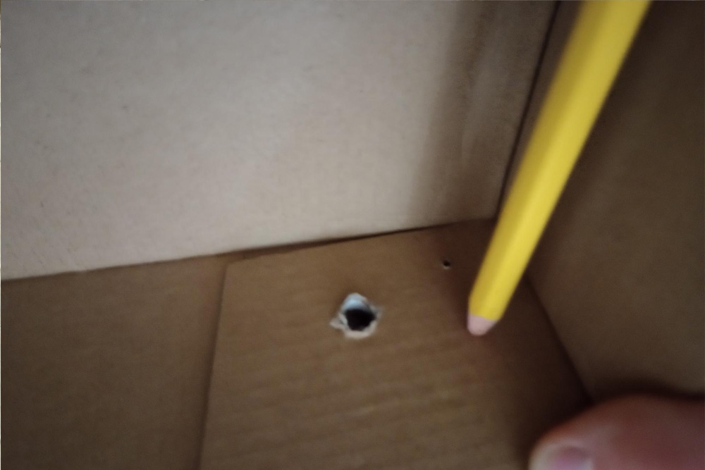

  6. Once you have a big hole with 3 holes around it, you have almost finished the motor mounting holes. Now make a hole like in the picture below. It doesn’t matter exactly where you put the hole as long as it is close to the circled hole.

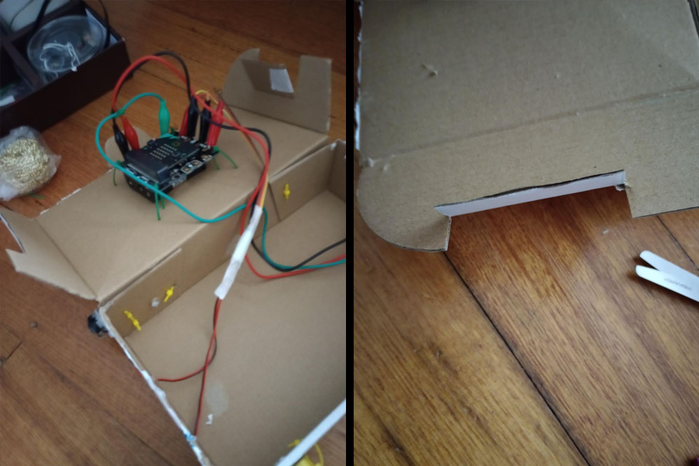

  1. Mounting the motor driver: Put batteries into the motor driver. Using the holes on the top of your car, mount the motor driver inside the box, like in the pictures below. Make sure that the M1 and M2 connections face the GlowBit.

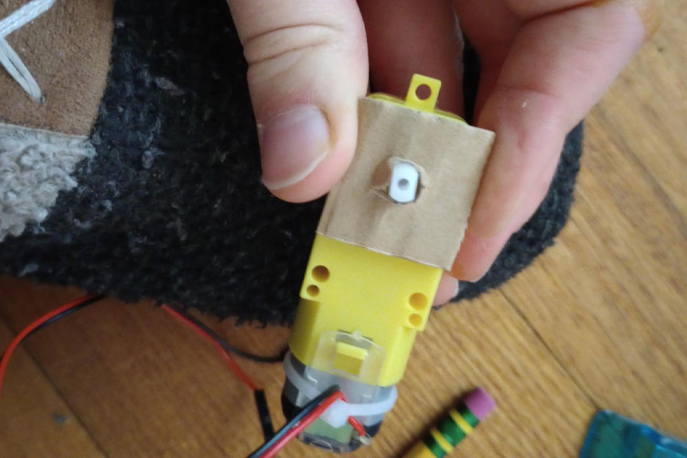

  2. Mounting the motors First, make a square of cardboard, and put a hole in it,  repeat until you have 6 squares.
  3. Place three cardboard shims on each motor. These will be used to make the motor sit straight. Ensure you put them on the side where the wires are attached.
  4. Then put the motor’s axle into the hole, with the 3 squares between the box and the motor. Secure it with cable ties.
  5. Put the jumper wires through the back hole. Repeat everything for the other side. You should end with 2 motors attached and 4 wires inside your car. Then attach the wheels.

  1. Connect the wires onto the motor driver like this (ignore the 3 wires on the side if you are not using a GlowBit) :
  2. Then connect the Alligator-Female wires, and tape the wires together, otherwise, they slip apart easily.
  3. Cut out flaps for the motor wires. These will let the box close properly.

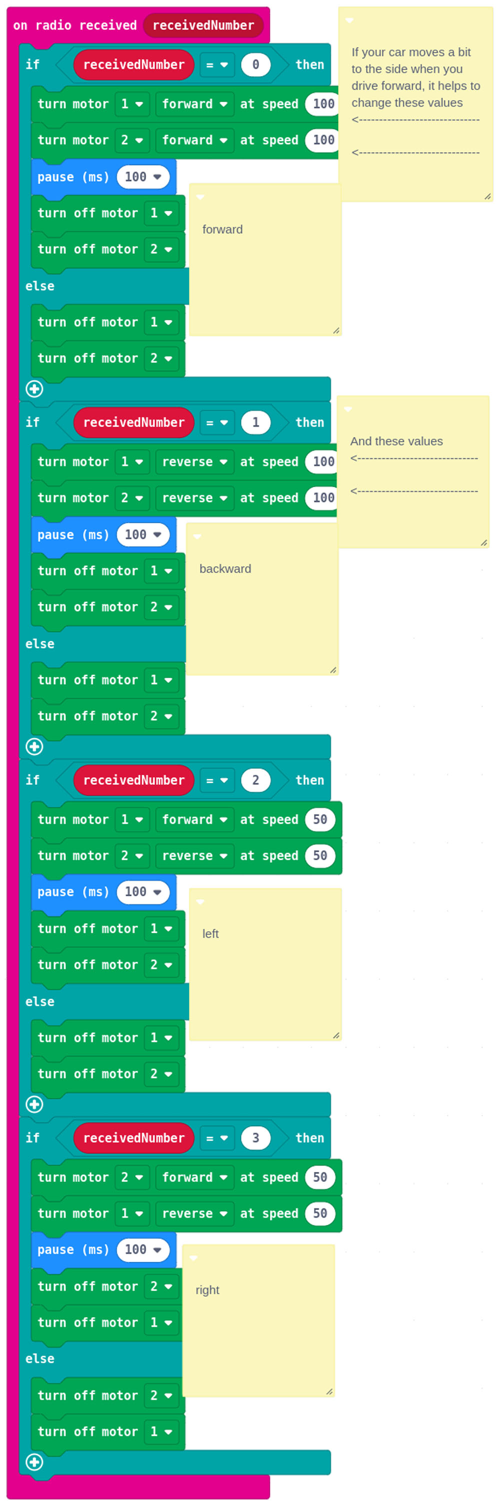

  2. The code for the remote is below. Put this code onto a separate micro:bit. I didn’t use A+B click because it would get mixed up between A, B, and A+B. Using the tilt, the car can simultaneously drive forward and turn.
  3. The code for the car is below. Upload it to another micro:bit, then plug that micro:bit into the motor driver.
  4. Press button A to go forward. Press button B to go backward. Tilt right to turn right. Tilt left to turn left.
