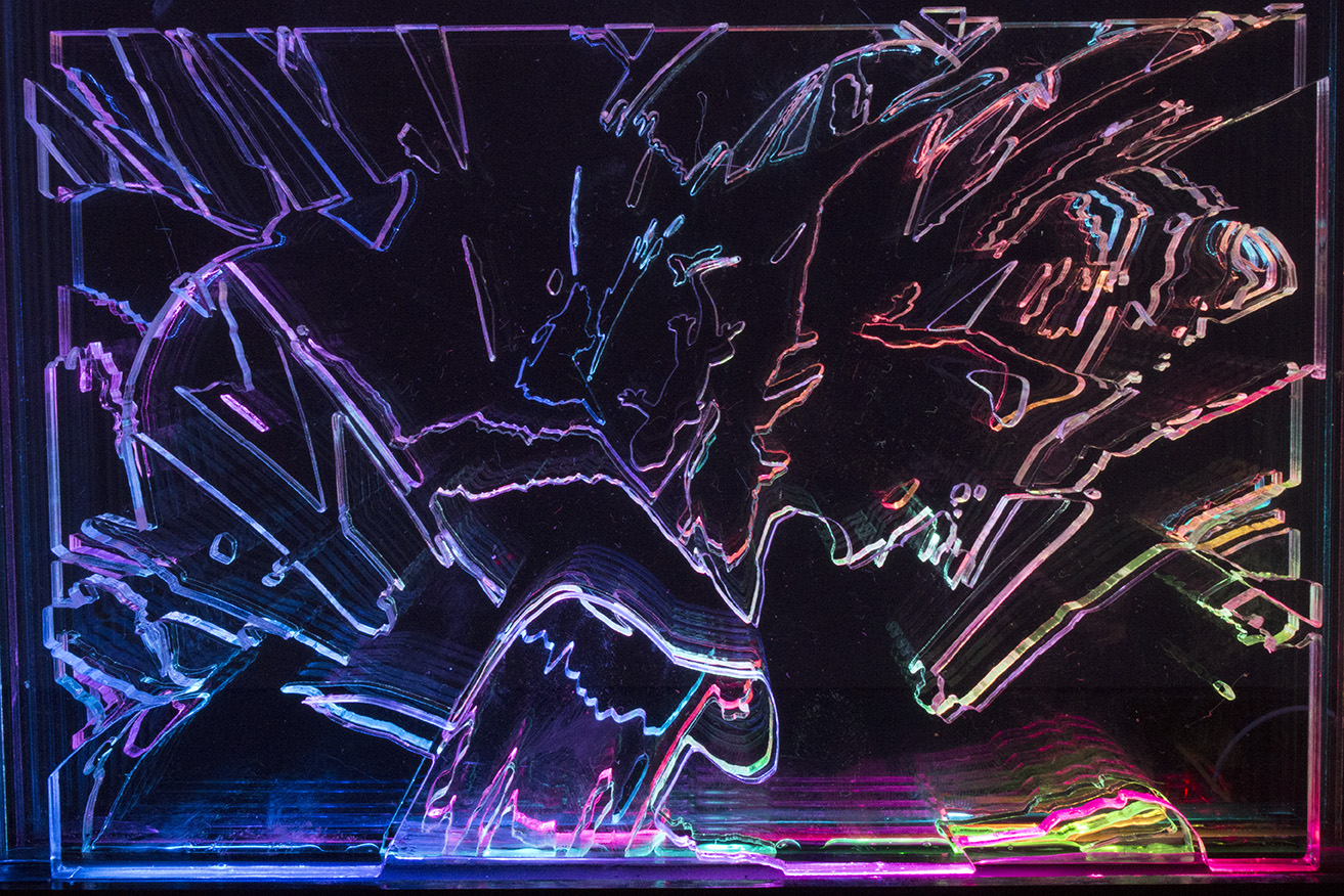

The idea was to leverage the light transmitting properties of clear acrylic sheeting and pass LED light through it; interfering the transmission using laser cut edges which would cause the light to highlight the lines thereby creating a painting with light.
For this task, I wanted to explore the materiality of clear acrylic and the application of coloured light.

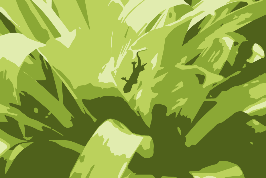

I then used Adobe Illustrator to create a 4 colour trace of the image, allowing the isolation of each layer of colour used to create a laser cut outline

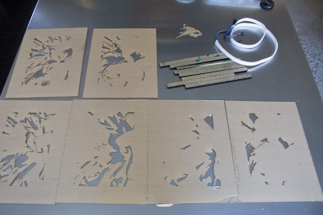

These were then cut out of sheets of 6mm clear acrylic using large CO2 laser.

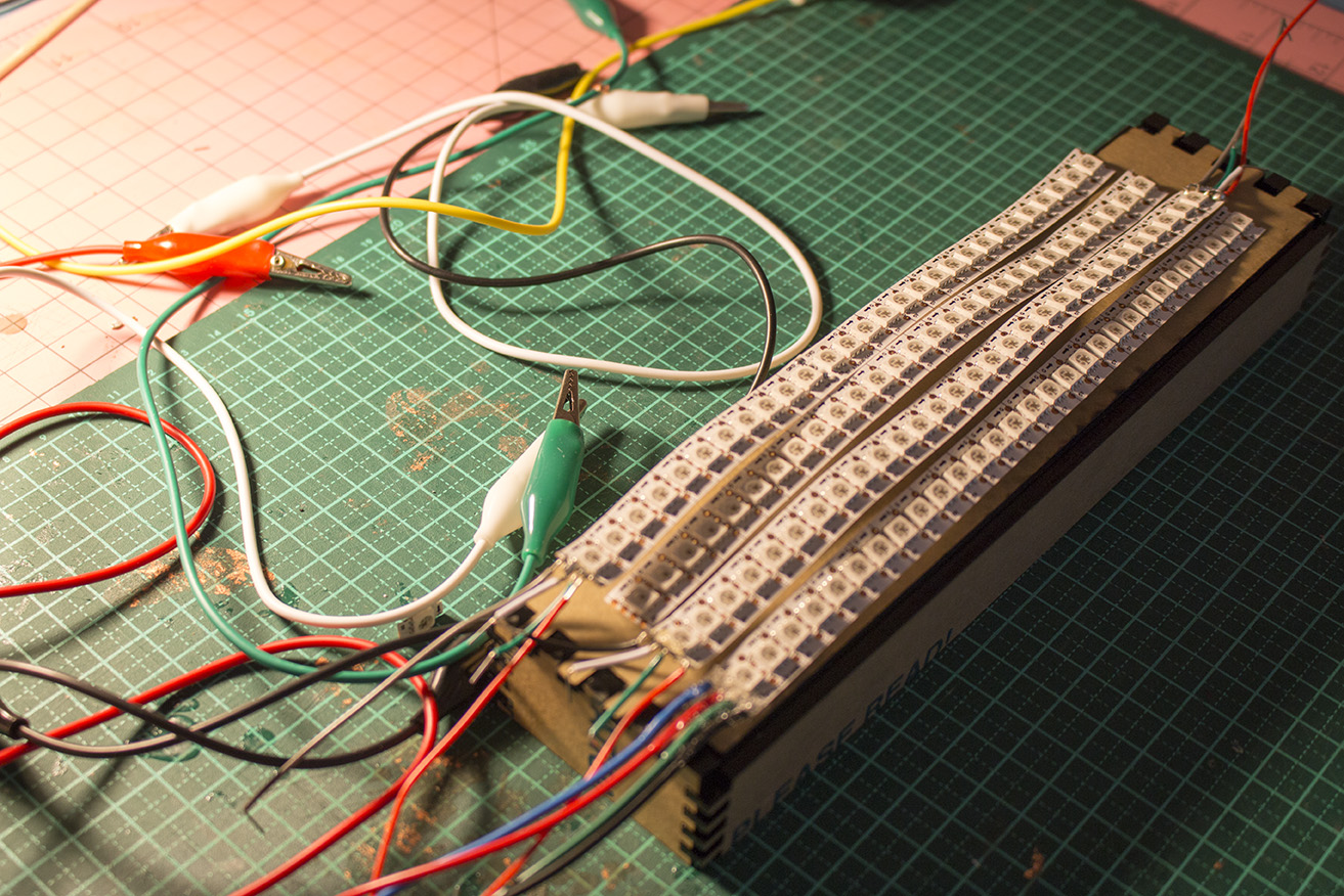

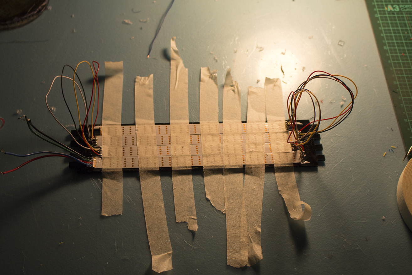

The electronics used were an Adafruit Trinket Pro 5v microcontroller and a strip of densely packed Dotstar type RGB LEDs. The Trinket allowed me to program the LEDs using the Arduino IDE. The LED strip was cut into 4 lengths then wired together in sequence allowing me to create a physical 2D array while maintaining a logical 1D serial array for ease of programming; which was done to create a continuous slow-moving rainbow effect.
The strips were glued to the underside of the lid of the box structure, and the Trinket was mounted on a mini breadboard with a self adhesive back which I stuck to the bottom surface of the box allowing the micro USB cable to protrude from a small hole cut in the side panel. Power is supplied in this case via a USB cable which has the added benefit of allowing me to reprogram the LED display should I ever wish to.
