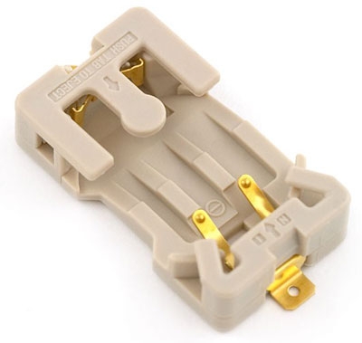

Battery Holders
The last thing to know when creating paper circuits using copper tape is how to connect a battery. There are two different methods that I like to use, one incorporates a momentary on/off switch with the battery and the other allows for a more permanent battery connection. You’re definitely going to want to use conductive adhesive for this.
Something to be careful here is not to create a short circuit, so be sure to place your tape far enough apart so that the battery can’t accidentally short out.
Battery Switch
To use the battery connection as a switch, just take the same approach as a momentary switch, but use the battery as a contact. Double over some tape on the bottom side of the battery to hold it in place, and just press on the tape to turn the circuit on!
Battery Holder
To create a nice battery holder, double over some tape to attach your battery to the first track. Now, run the second piece of tape from your other rail to the top of your battery, and voila! A clean, reliable copper tape battery holder.

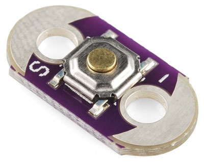

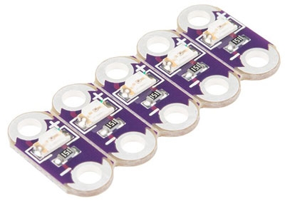

Using Wearable Components
A great trick when creating paper circuits is that most wearable modules and components have large, round, flat pads for sewing too, which makes them great for paper circuits. Some of our recommendations are:
