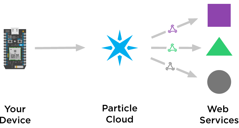

What are Webhooks?
It’s a good question, formally classed as ‘user defined HTTP callbacks’, they can seem confusing a complicated a first, however let’s take a look at what a webhook really is.
Think of a webhook as a bit of code that sends out a ‘message runner’ to the website you want to get data from. Now it will take a certain amount of time for our ‘message runner’ to get to the website, get the data, and get back to our program. We could spend all of our resources on the lookout for this ‘message runner’, waiting for him to get back with our precious data, or we could simply go about our business, and trust that the message runner will let us know when he gets back with the data we sent him to get.
In a more practical sense, most web services designed for integration with development tools will provide an API which is a URL you can request data from. We send out a request for the data we want, then the web service replies with said data, and we can then process it however we want.
Fortunately, once again, Particle have come to the rescue and made it extremely easy for us to integrate webhooks into our code and leverage the power of the internet. If you’re just getting started with Particle, definitely go and check out the rest of our Particle tutorials to get a good understand of how to work with the Particle platform first.
How do we use Webhooks in Particle.io?
There are two Particle functions that we’ll be using to integrate webhooks into our code: Particle.subscribe and Particle.publish. There are lots of different ways you can use webhooks however we’ll be sticking with something fairly simple to demonstrate their use.
The easiest way to learn about how these two functions work is to check them out in the firmware documentation on Particle.io. It runs through the parameters required for each one, and how they communicate with the Particle.io cloud. Anyway, enough talk, let’s dive in a look at using webhooks in our own app.
