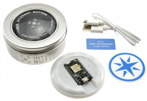

Particle has seen this and introduced a rather fantastic product called the Internet Button.
And it is glorious!
It’s a Particle Photon with a circular shield that has 11 RGB NeoPixels, a 3 axis accelerometer, 4 heavy duty tacile buttons, a Piezo speaker, stackable breakout headers, all in a sleek, circular container that can be used to contain everything.
The best part is that Particle have created a supporting library for it that demonstrates every feature in an amazingly creative way. We can make music, create light shows, create motion gestures, and best of all, use the button input to control the internet!

All you’ll need to follow along is your very own Internet Button! Everything we’re doing is contained in this fun, compact package.
Setting up the Internet Button
Getting started with this amazing bit of tech is super easy. Open up the container and take out the Photon with the Internet Button board, and white plastic top still attached (the USB cable plugs in with this on). Claim your Photon as detailed in our Getting Started with Particle Photon, and just like that, we’re ready to test run some awesome apps.
