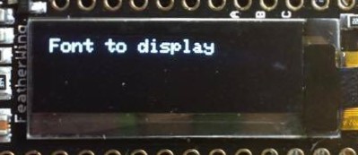

To write words to the screen, we can then use a couple of display functions that allow us to choose where and what to write:
display.setTextSize(1); //Set our text size, size 1 correlates to 8pt font
display.setTextColor(WHITE); //We're using a Monochrome OLED so color is irrelevant, pixels are binary.
display.setCursor(0,0); //Start position for the font to appear
display.println("Font to display"); //Will display text on new line
display.display();
text-to-display-oled

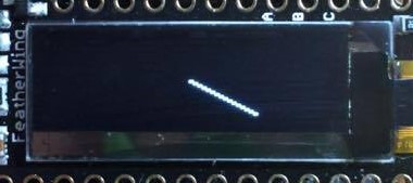

If we wanted to draw a line, however, we need to provide the start and end pixels to our sketch.
display.drawLine( Start-X, Start-Y, End-X, End-Y, Color);
drawLine-example

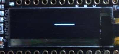

The drawLine function does angular calculations to fill in perpendicular grid squares, so they match a line shape. This isn't the best/fastest method to draw a line if it is a straight vertical or horizontal line. The drawFastVLine (and HLine) functions are great for this purpose exactly.
display.drawFastVLine(X-Start, Y-Start, Pixel-length, Color);
horizontal-fast-line-oled

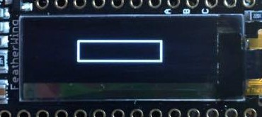

Pixel becomes Line; Line becomes shape! To draw the border of a rectangle shape, we simply drawRect. If we want to fill it in, we fillRect.
display.drawRect(X-Start, Y-Start, Width, Height, Color);
drawRect-oled-example

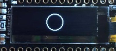

For a circle, we need a centre point and radius, we can also fill circles or just draw their outline:
display.drawCircle(X-Center, Y-Center, Radius, Color);
drawCircle-display-oled
