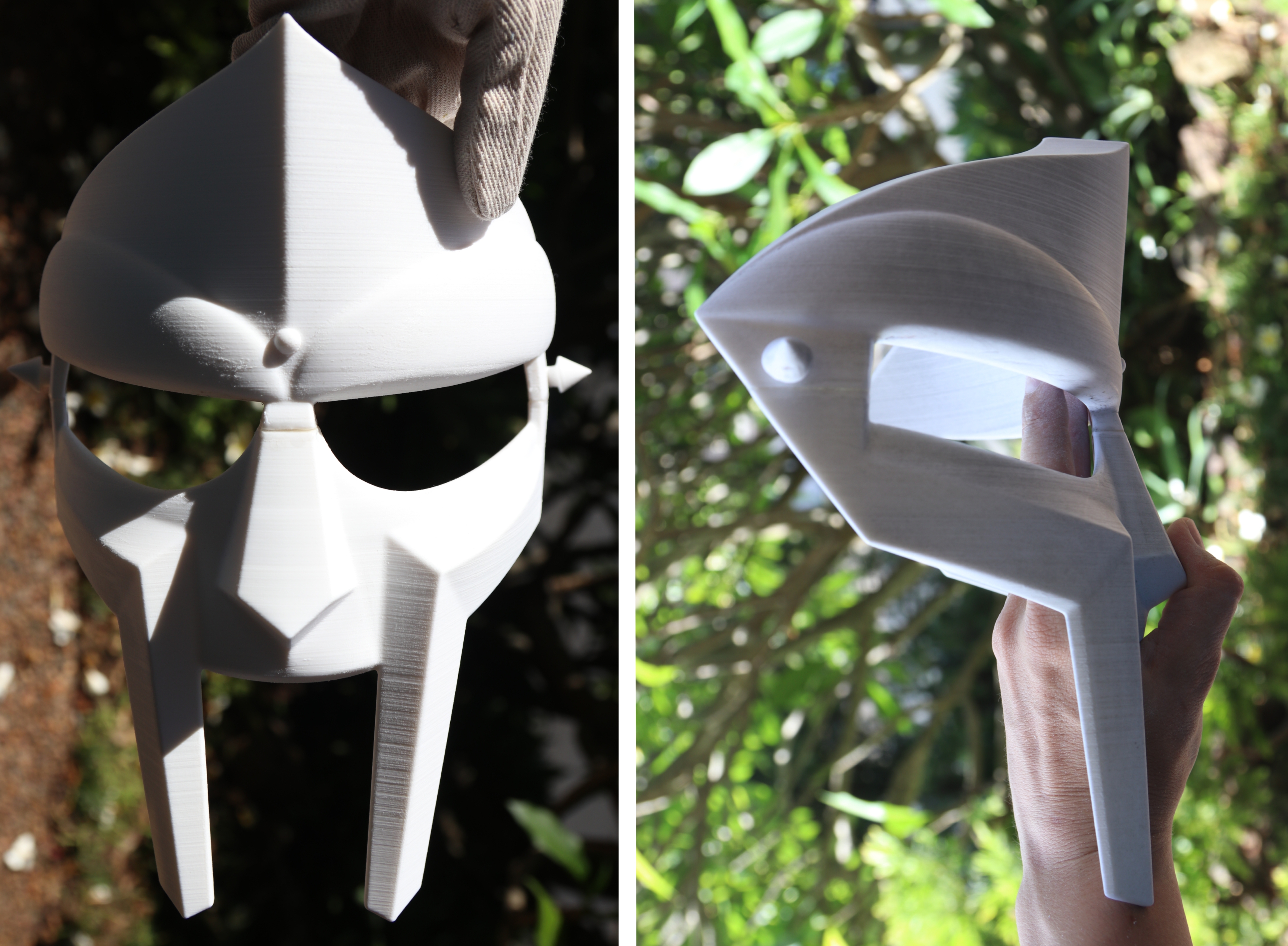

Now most importantly is the before and after shots, so here they are. Below you can see them for a 3D printed mask and a 3D printed hand sculpture. The STL files for these models can be found at the bottom of this page if you want to have a go printing them yourselves. Also, if you don't have a 3D printer we have 3D Printing Services that you can use to get your designs sent directly to you and into your hands.
Before and After Mask
Before and After Hands

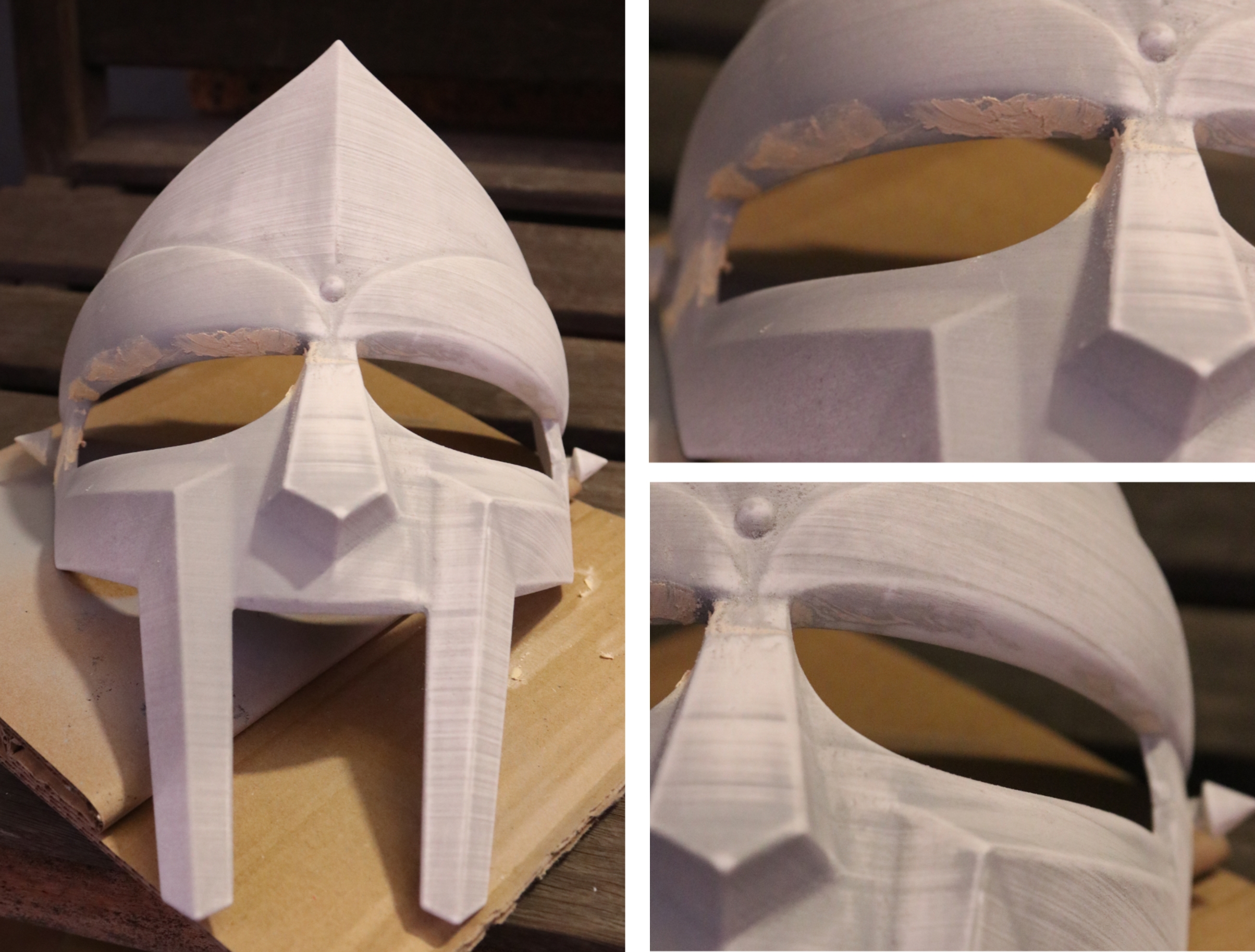

For both these finishes it was crucial to sand down and add layers of primer to the surfaces. This is to smooth out the layer lines so the model looks beautifully smooth when painted. The mask also needed to be assembled in which I used superglue to adhere the two pieces. For the mask I also used wood repair putty to fill some of the larger holes from marks left by the support structure which I would then sand back even. This was a new technique that I had not used on 3D prints before and it worked out beautifully. In the image below you can see under the two eyes of the mask with one with the putty dried after application and the other with the wood putty then sanded back.

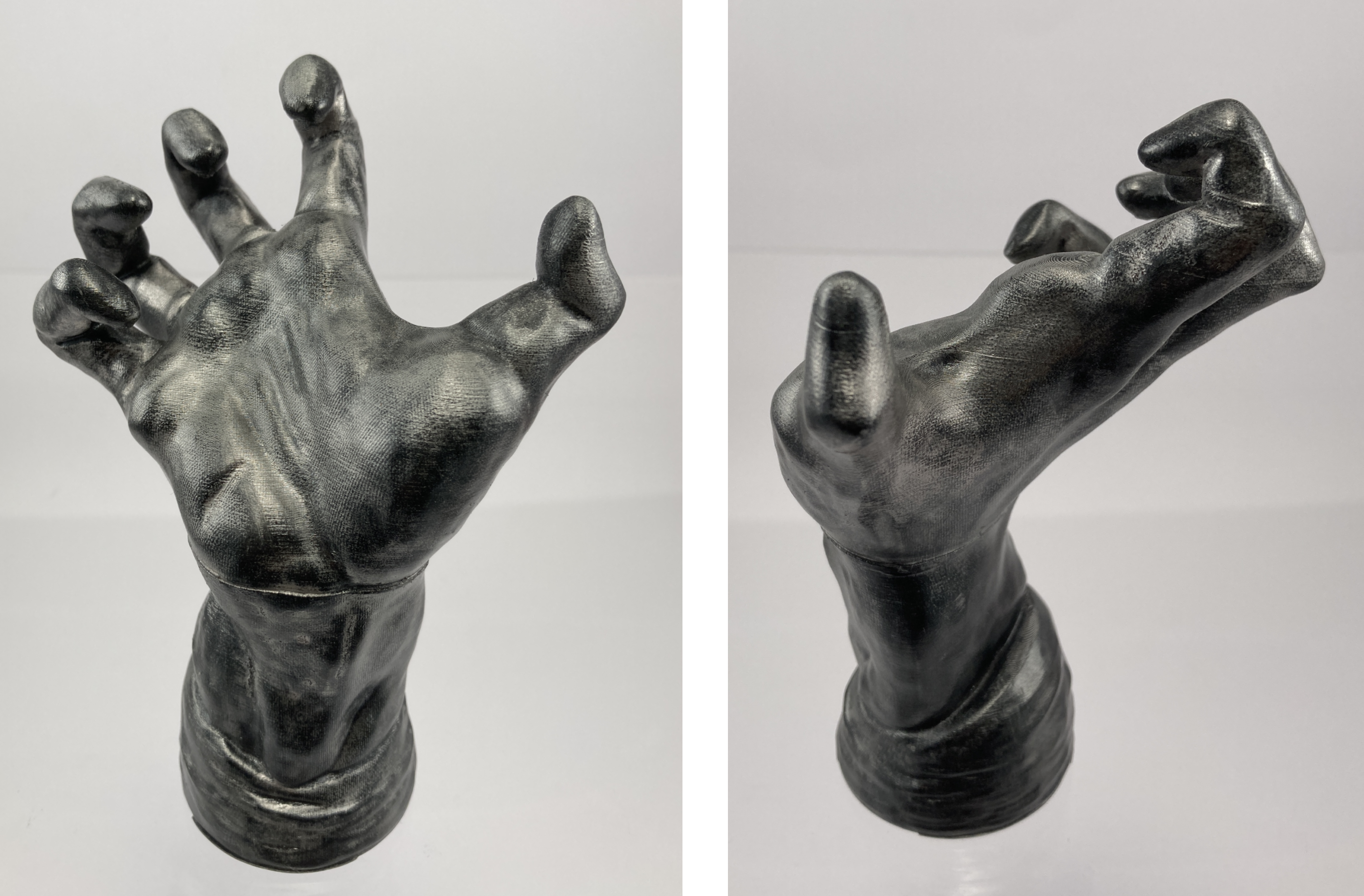

The Rub N Buff and the Pearl Ex Powder Sparkledust in combination make for spectacular finishes. The process I go through to do this finish is:
  • Apply two coats of matt black as a base coat layer using Black Spray Paint
  • With a small paintbrush applying the Pearl Ex Powder. Really definitely make sure you are wearing a mask. This is more about rubbing all over the surface, getting the powder residue into all the nooks and crannies. The tool to use here is a small painting brush as the static electricity picks up the dust. By dusting it all over the surface you get glints of light that emulate that metallic sparkle you get from raw iron ore. Currently, it will be very easy to rub off the surface of the object and this powder has the capability to go everywhere so plan how to minimise mess before you start.
  • Next, apply two coats of High Gloss Clear Spray Paint. This will seal the Pearl Ex Powder onto the object.
  • Finally, apply the Rub 'N Buff. A little bit goes a long way that Rub N Buff, make sure to use gloves when using it as it does like to stick on fingers. Rub 'N Buff is that special secret to better cosplay and completely new to me before this project. The more you rub it off the better the final result and it makes a huge impact on the final result. Acrylic paints can also be used instead for this stage but I find Rub 'N Buff easier to apply.
Below is the final result of this process. If I was to do it again I would use slightly less Rub 'N Buff and taken more time in the post-processing to hide the point of connection near the wrist. Nevertheless very happy with the result. The Model comes from Scan The World and is a scan of The Mighty Hand at the Musée Rodin in Paris. Auguste Rodin (1840-1912) was fascinated by the human hand and spent a large amount of time producing very emotionally charged sculptures of hands out of marble and metal. Big thanks goes to Mieszko Lacinski for the great scan.
