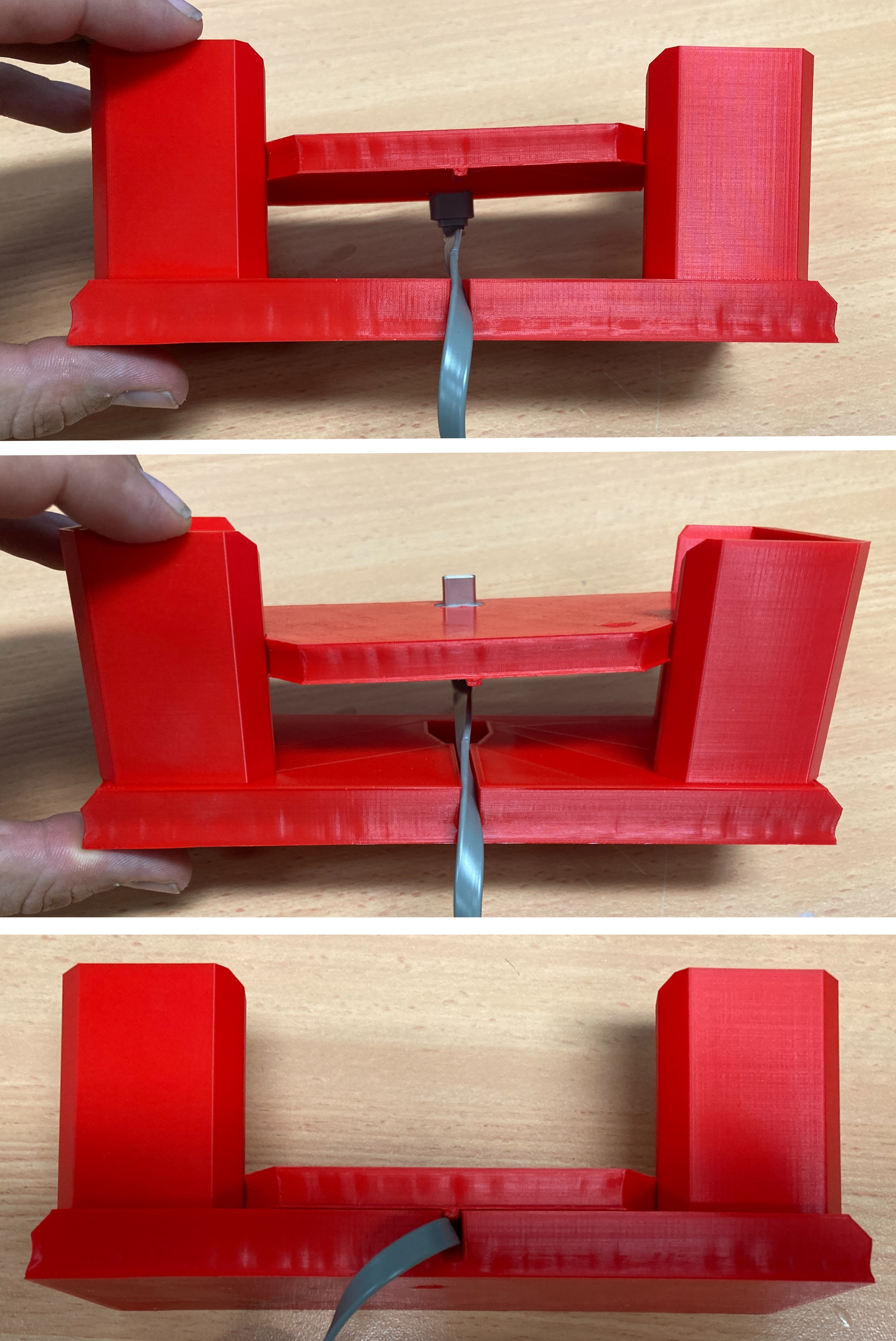

- 8BitDo Pro 2 and 8BitDo SN30 Pro Charge Dock Design
Pro 2 and Pro   ON Charge Dock Yayay
Pro   Design Isometric
- 8BitDo Pro Charge Dock Design
Pro Mount Design Front
Pro Mount Design Isometric
- 8BitDo M30 Charge Dock Design
M30 8BitDo Design Front
M30 8BitDo Design Isomtric

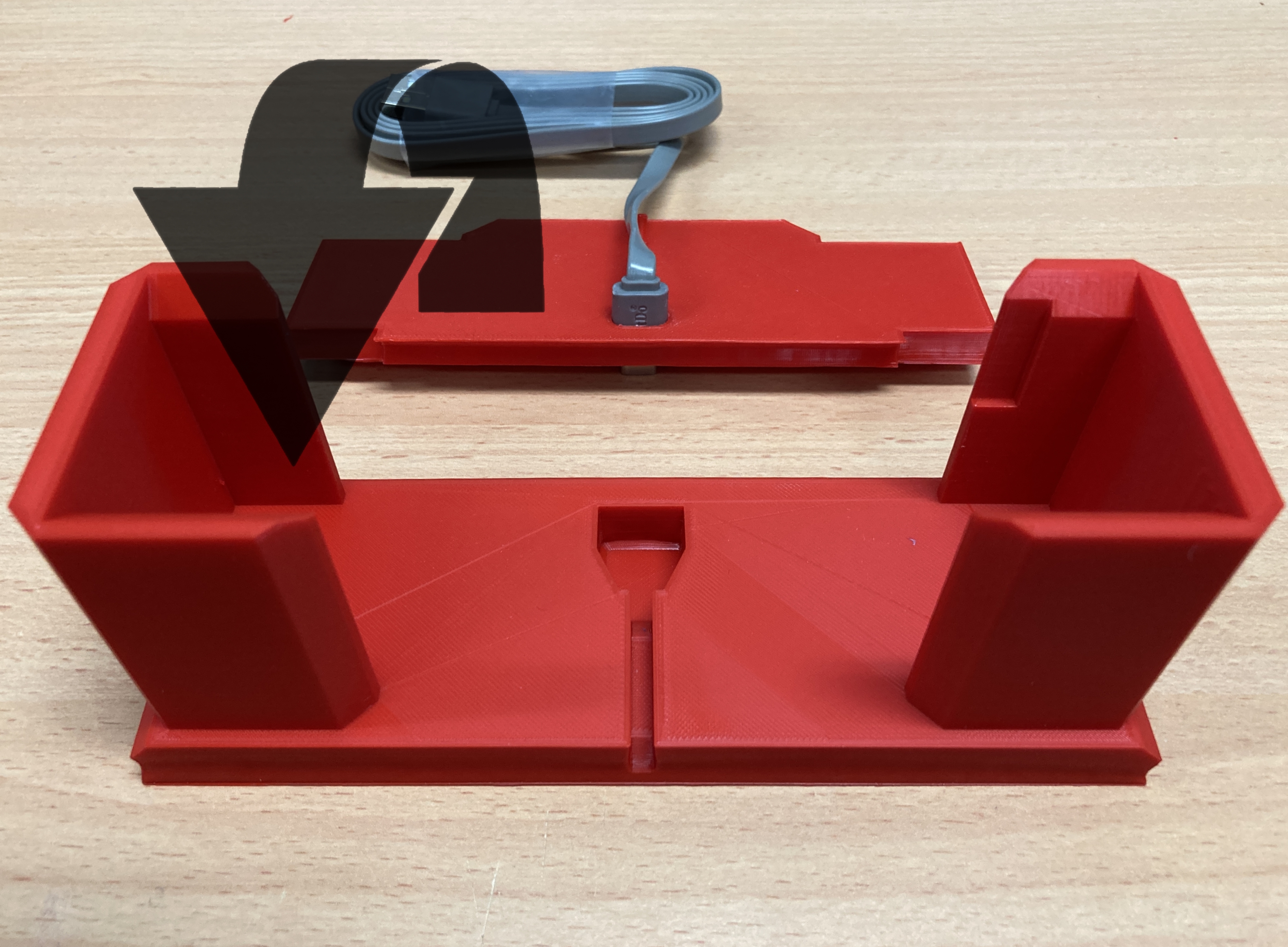

All of these Charge Docks are made up of two parts (except for the blue dock which has a little extra embellishment printed to give it the two-tone colour. It isn't necessary for functionality but I have attached the files below so you can do this too if so desired). Below you can see one opened up. No glue is required to make them fit firmly together it is just sturdy press fits. Start by pressing the USB-C through the hole on the top plate until the plastic is flush with the top. On the 8BitDo M30 Charge Dock push the USB-C a little bit further so it sits around 4.5mm proud of the top plate.
Two Part Design
Using the 3D printers here the design makes sure that the USB-C plug fits snug straight off the print platform. Due to print variations with 3D printers you may need to file the hole ever so slightly larger or wrap a small amount of tape around the plastic of the USB-C to ensure this snug fit. Once happy you can then press the two parts together. Make sure not to clip the edge of the USB wire when doing so. Below you can see the back of the design and the process of pressing the two parts closed together.
Assembly Of Parts

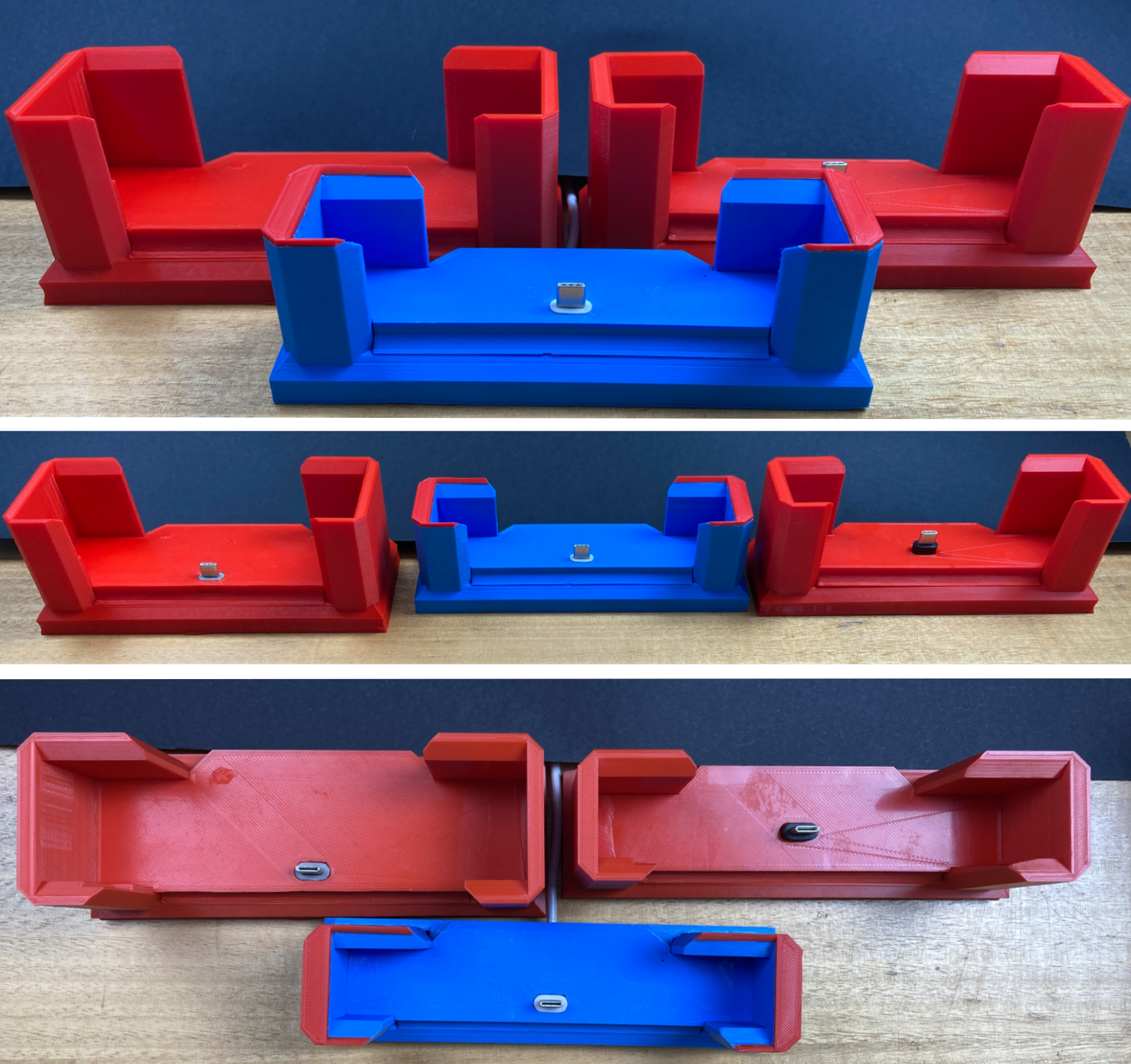

Below is some images of them all assembled without controllers, Left dock is for the 8BitDo SN30 Pro , the Middle dock is for 8BitDo SN30 Pro and the Right dock is for 8BitDo M30. Each of them is a different size so make sure when you 3D print them to 3D print the right one for your controller. Also the 8BitDo Pro Charge Dock has a little red topper embellishment which is not necessary (but it does look fresh). I printed it separately and superglued it to the top. Once assembled all you need to do now is plug in that USB-C cord to power and dock your controller.
All the Mounts Lined up
