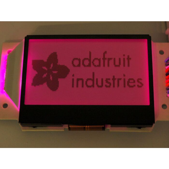

This graphical display looks great, costs less! The dark gray pixels are visible in daylight, and there's also a full RGB LED backlight, which you can control with PWM to make any color you can imagine.
Four mounting holes and a blank 11 pin 2mm-pitch labeled breakout on the side - Adafruit just soldered some wire to each hole as shown in the photos, its very easy. (The LCDs have no wires soldered in when Adafruit ship them)
