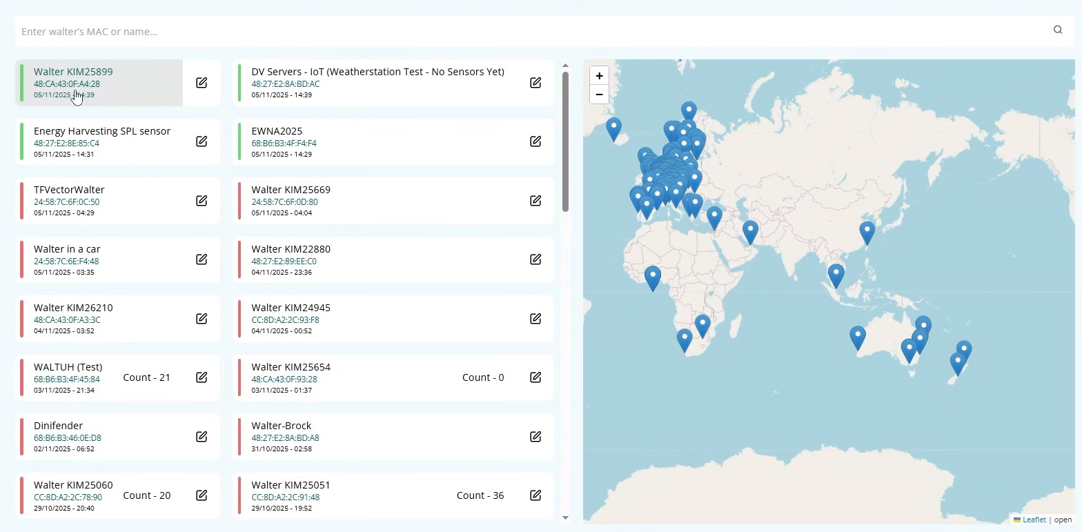

If you power on your Walter, you will actually fire up a pre-loaded demo. Head to the Walter demo page, and your device should show up and report basic information from your board! You can tell which board is yours by the MAC address, which should be on the bag Walter came with. This is a nice little way to test that you have everything set up right.
Please note that this is a public site and anyone can see your Walter's location (your location!). Once you turn off your Walter, the location should not be visible anymore. If you do not wish to use this demo, do not insert a SIM card until after you have flashed your own firmware onto the board.
Also, don't worry about there being a big-Walter surveillance state monitoring your every move. The demo code is written to send data to this site, and when you flash something else onto it, \they will no longer receive information.
