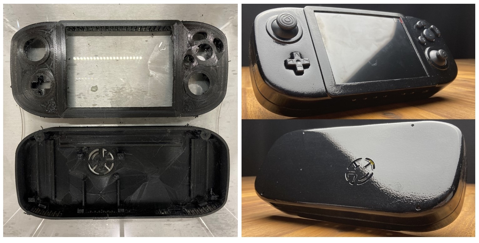

Below is a clamshell case for a handheld electronic device, left is before, right is after. This is the part that I will go through the process of cleaning and making really. Further below I will have other examples of post-processing 3D printed parts with different colours of spray paints.
Before and After

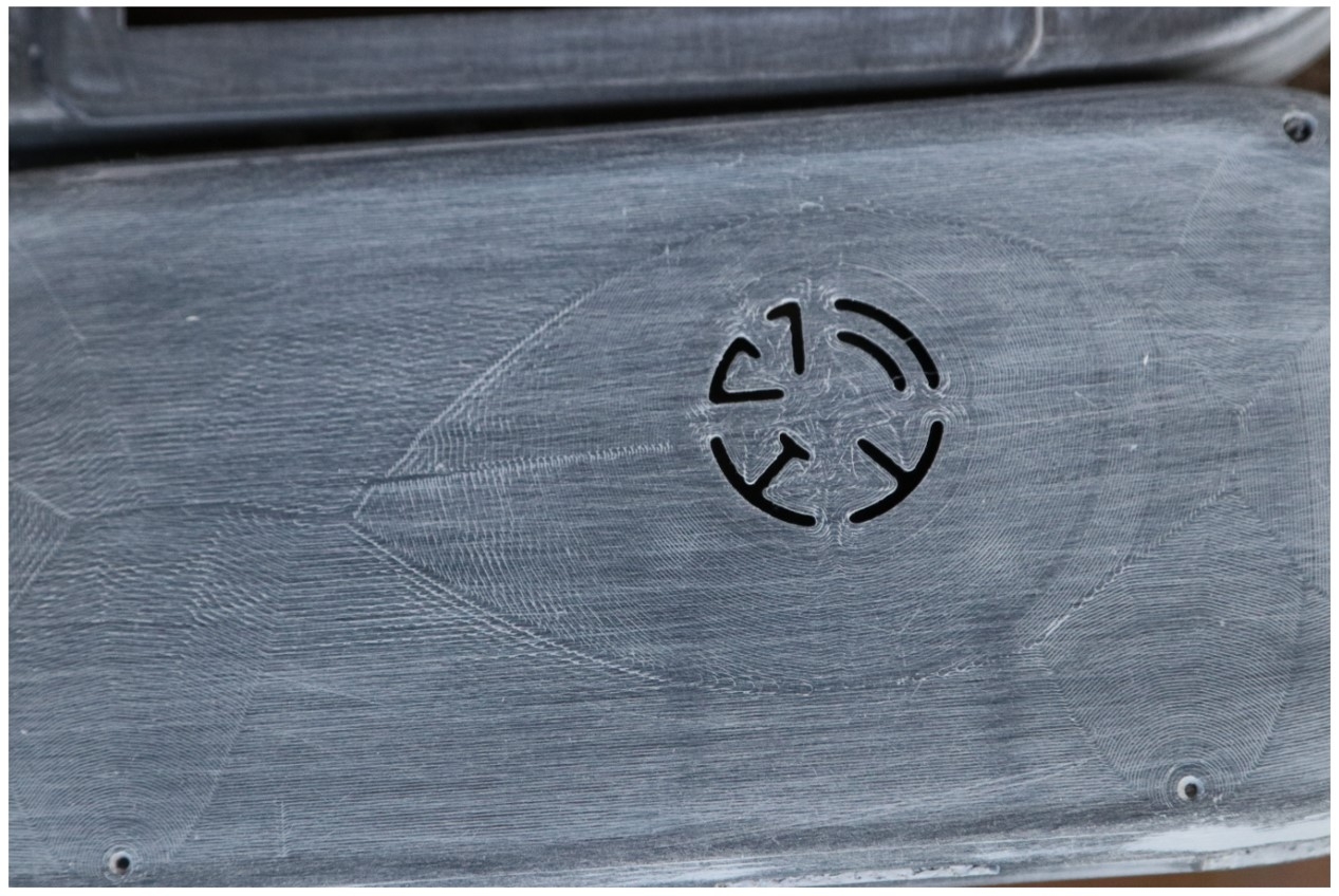

Stage One: Initial Sandpaper to help the first layer of primer to stick. 280 Grit is a good starting point.

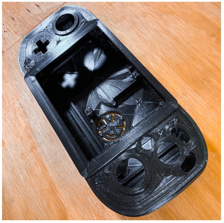

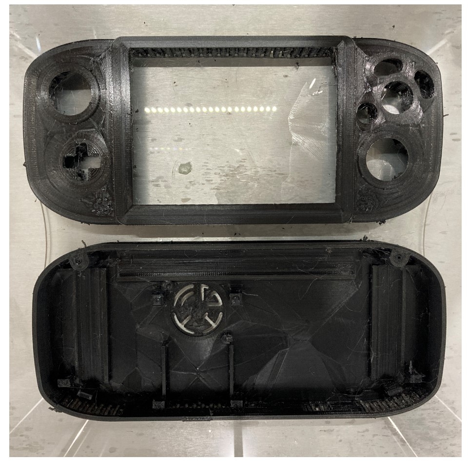

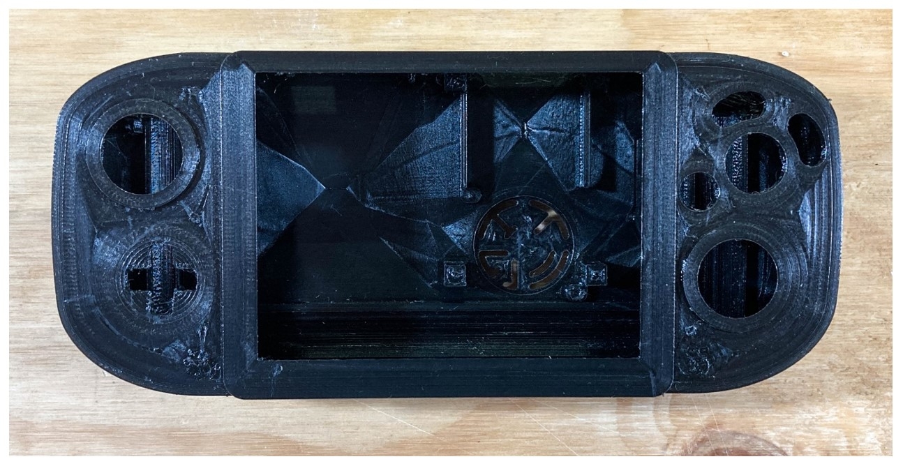

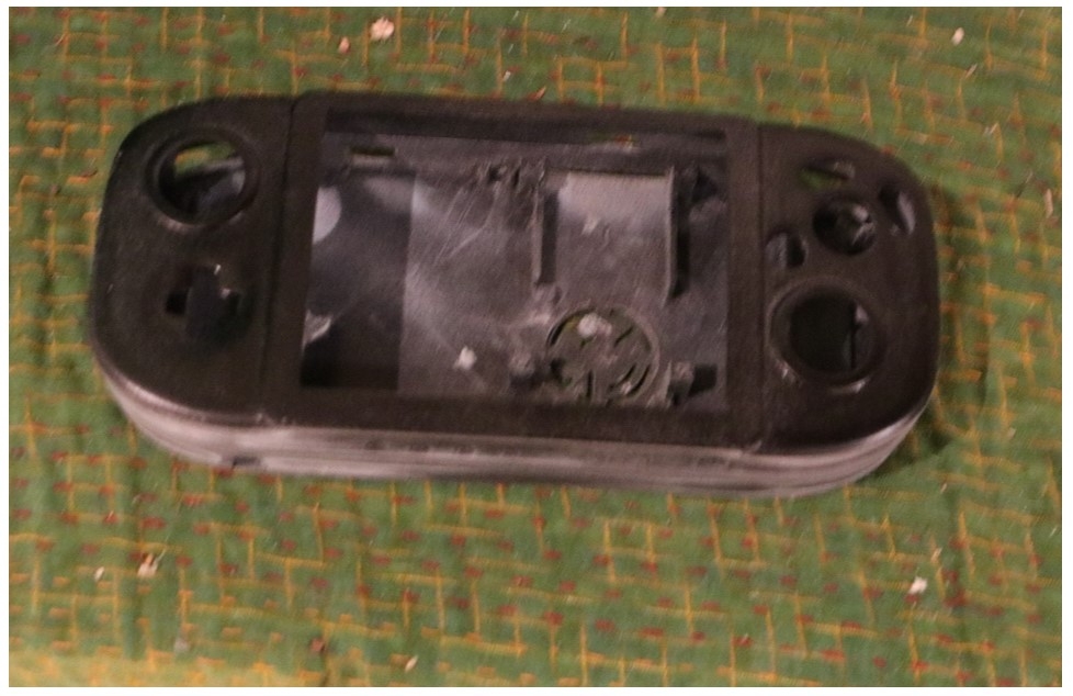

Below are images from Stage 1 -  One image of it Printed on the Build Platform, both sides were printed at the same time. Two images of it Raw from the Ultimaker S5 3D printer and one image of it sanded. I utilised Ironing to make a smoother top surface which saved me a lot of initial sanding and post-processing.
Print just finished
Raw
Raw 2
Sanded

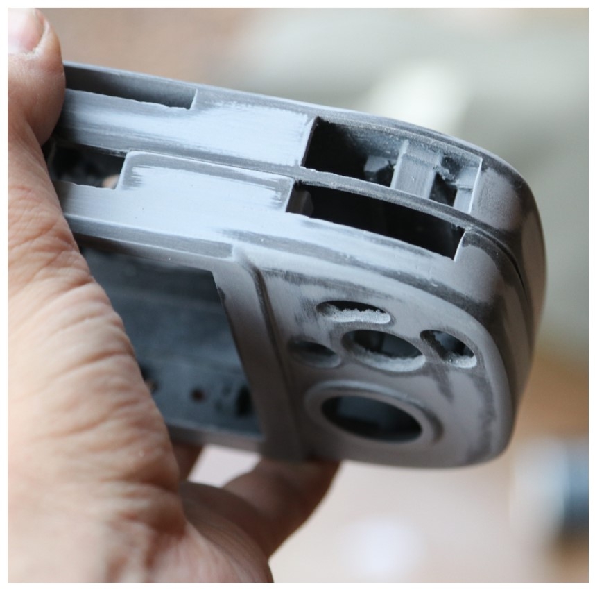

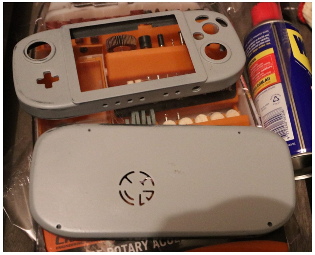

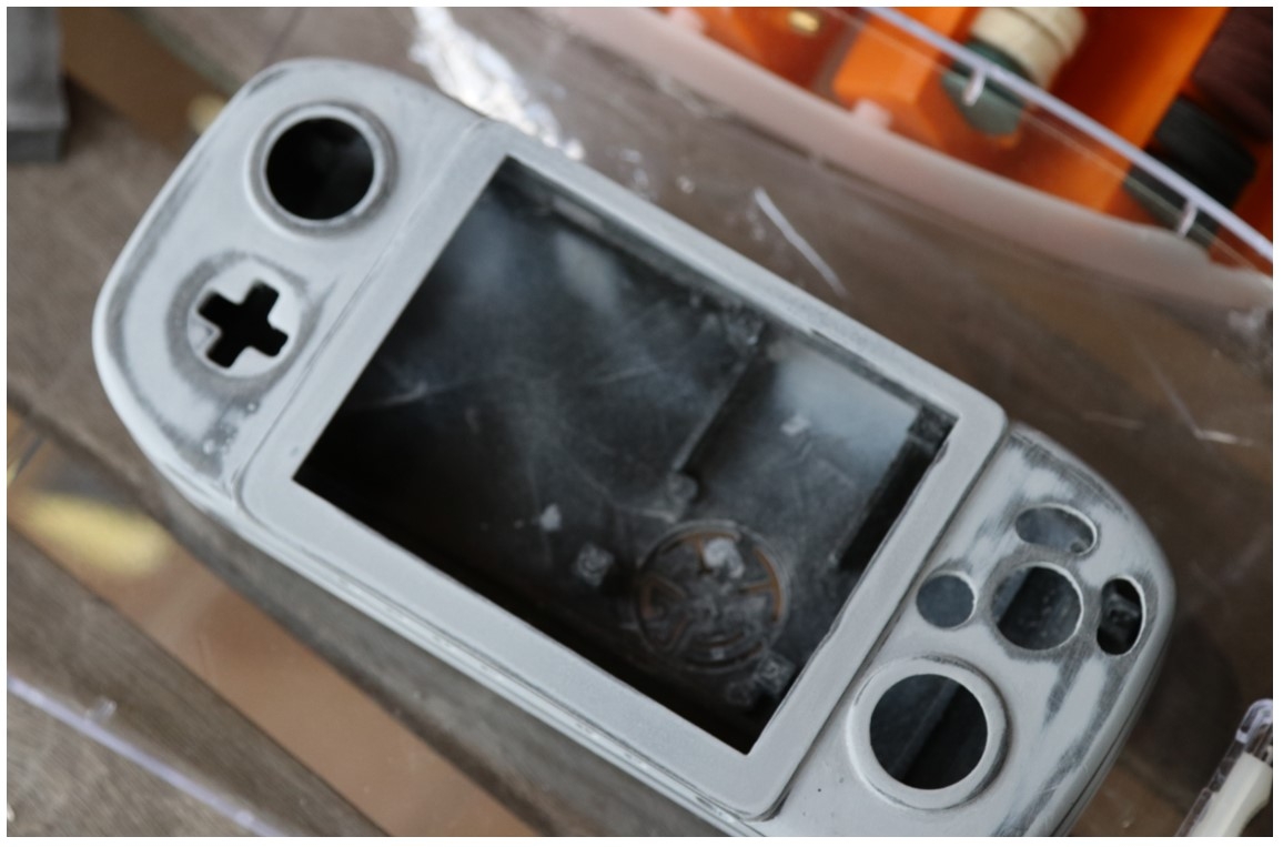

Below are images from Stage 2 -  Two images from the first layer of the primer sanded back. One Image of the last layer of primer just put on.
First Primer Layer
First Primer Layer Photo 2
Last Layer of Primer Not Sanded

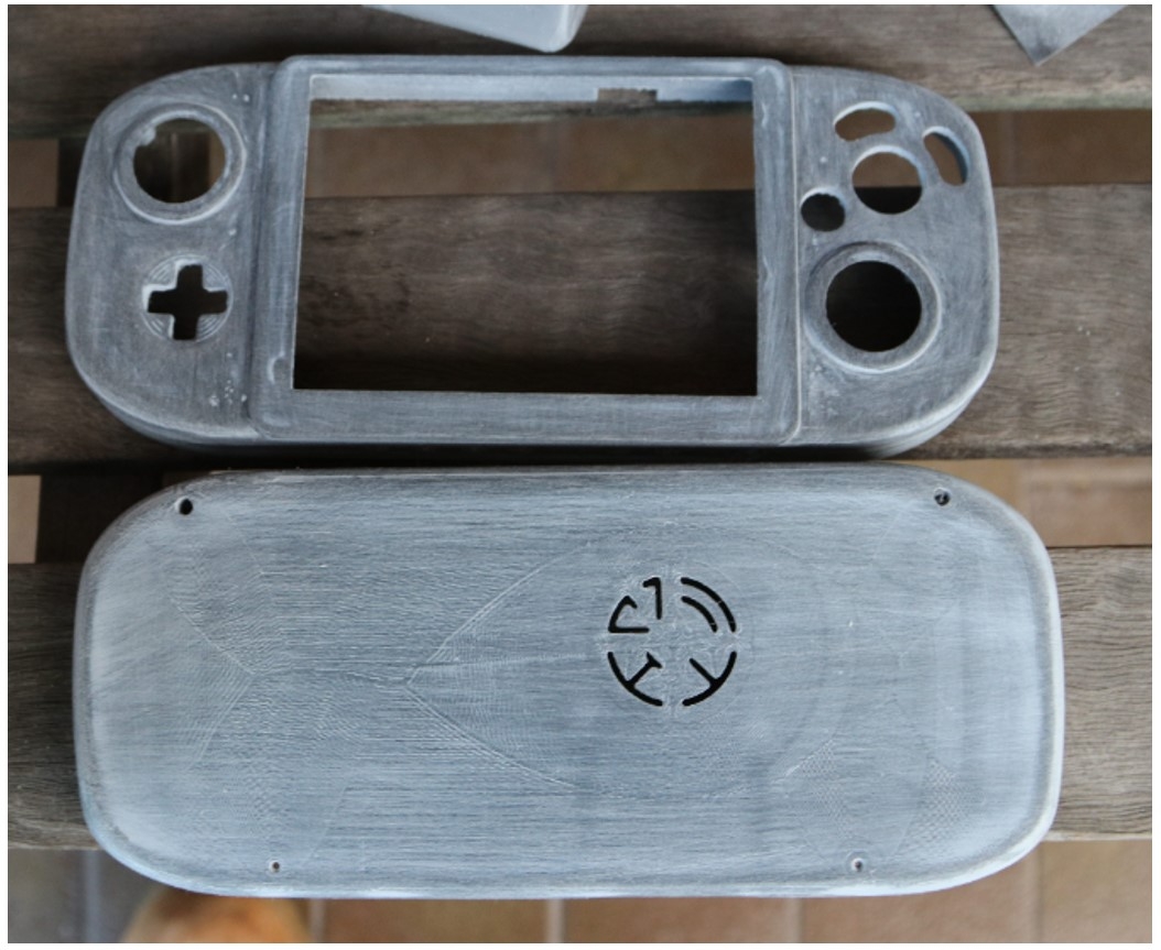

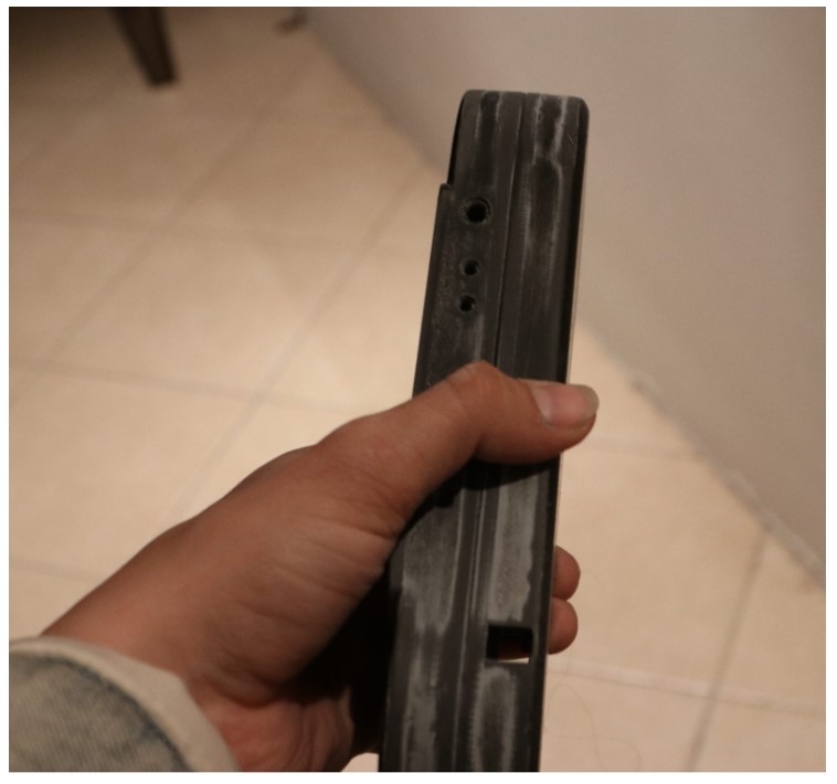

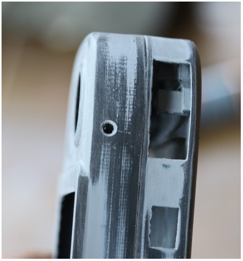

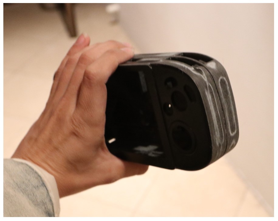

Below are images from Stage 3 - One image of that final layer sanded back with the intention of sculpting the final shape. Two images of the clamshell case put together and then sanded to improve the fit.
Final Primer Layer Sanded
Close up of clamshells put together and sanded 1
Close up of clamshells put together and sanded 2

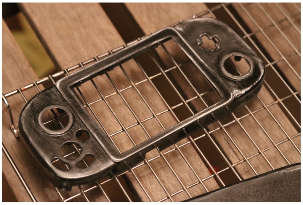

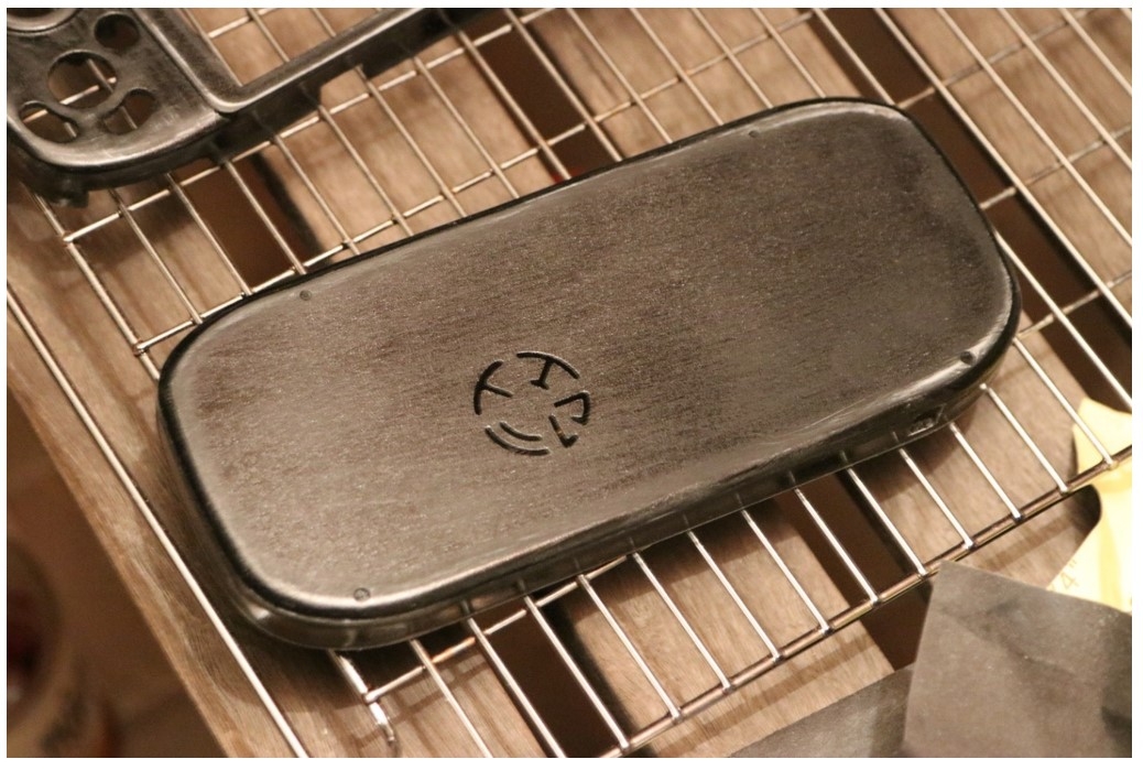

Below are images from Stage 4 - Two images of the first black spray paint layer where you can see how lightly it has been painted. Two images of the clamshell case put together and then sanded to improve the fit even with the spray paint on. Really shows the layers forming. Two images of the black spray paint second layer sanded back aggressively. And an Image of the final layer of black spray paint wet on the clamshell surface which was not sanded which is emphasised by a flashlight.
First Layer of Spray Done light
First Layer of Spray Done light second photo
Side View of sanded layers
Side View of sanded layers Photo 2
Spray paint second layer Sanded back Aggressively
Spray paint second layer Sanded back Aggressively Photo 2

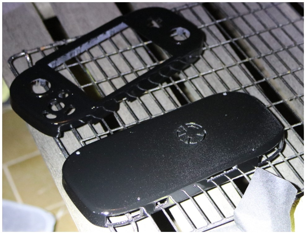

Final Layer of Black Spray Paint Which Wont be sanded

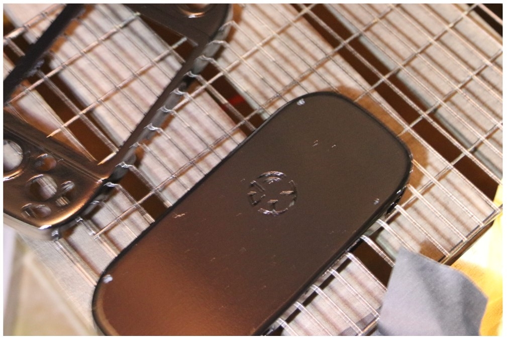

Below are images from Stage 5 - Below is an image is the first layer of Gloss and Clear Spray paint. Unfortunately, my photography skills decreased for this layer. This was sanded back lightly and then another layer of gloss and clear was sprayed on.
First Layer of Gloss and Clear Spray. Sanded back lightly soon
Below are images from Stage 6 - Here is an image of the final coat of Gloss and Clear drying in an airy and dust-free environment. Very wet at this point.
Very Wet!

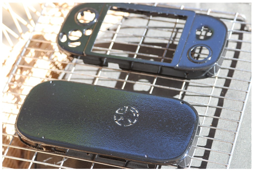

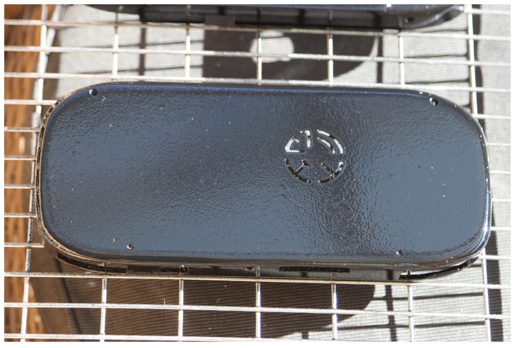

Below are images from Stage 7 - Below is three images from the next day of the clamshell in the sun. Looks dry but I assure you it is still very wet. No touching allowed for me till a week later.
Clamshell in the Sun 1
Clamshell in the Sun 2
Clamshell in the Sun 3

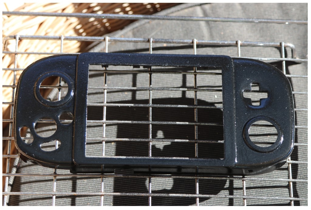

Complete - Below are two images of the Final Piece All dried and done.
Complete 1
Complete 2

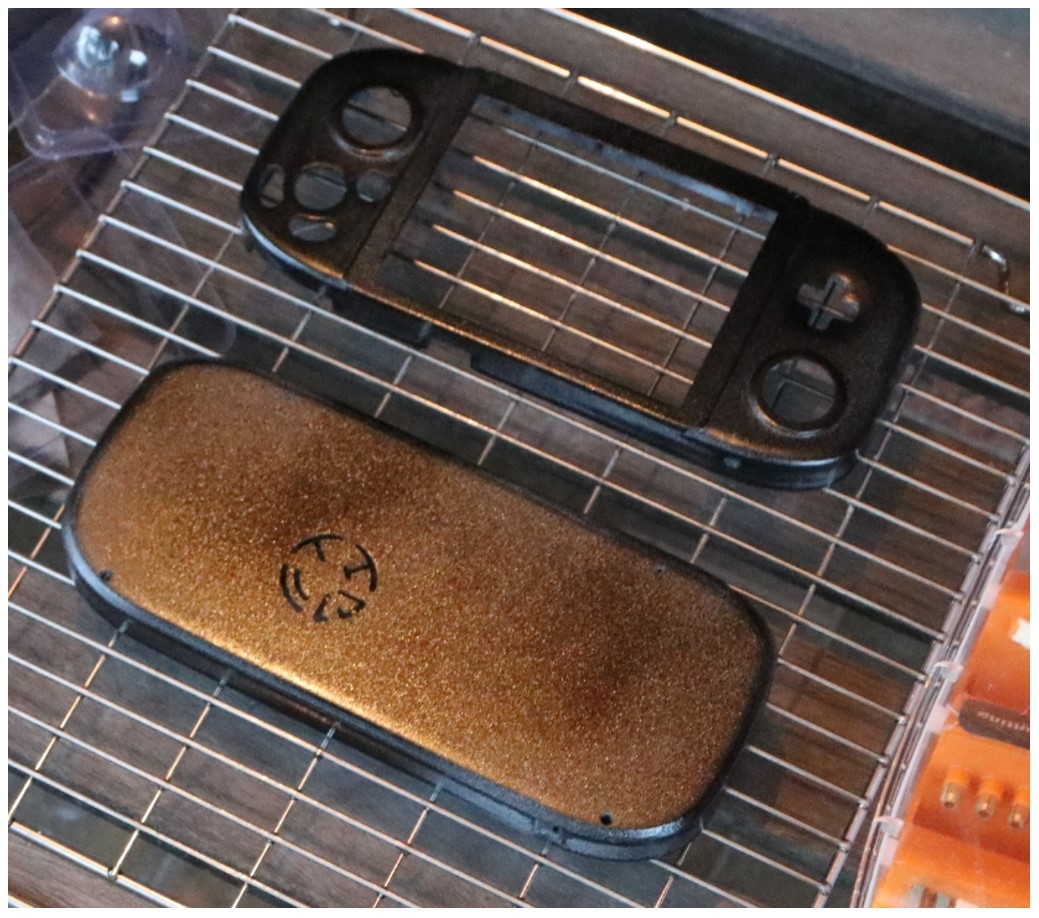

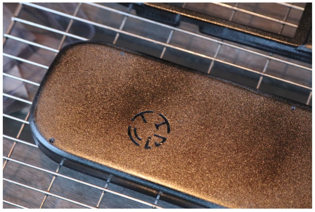

Other Paints and Post-Processing Methods for 3D printed Parts
There are lots of spray paints and colours you can use (just ask your local hardware shop) using this method. So long as you have a good couple of final layers of gloss clear coat for materials that you can grab the world is your oyster.

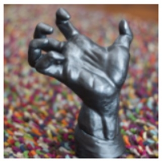

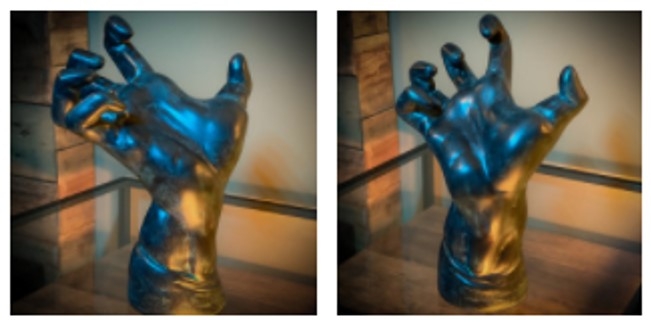

Airbrushing is definitely a fantastic way to get excellent results as well. And Acrylic paints can give an excellent effect like in the images I will show below. You can also fill your 3D printed models with Sand or other material to make them heavier. This will trick people into thinking they are made of stone or some other heavy material.
Examples 1
Examples 2
