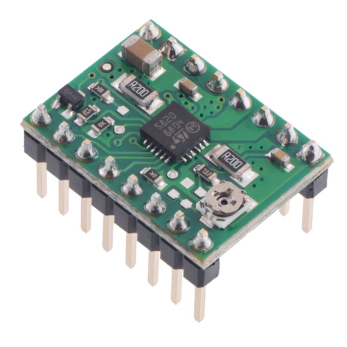

This version of Pololu's STSPIN820 Stepper Motor Driver Carrier ships with male header pins installed as shown in the main product picture, so no soldering is required to use it with an appropriate 16-pin socket or solderless breadboard. Please see the STSPIN820 Stepper Motor Driver Carrier product page for more information about the driver.
