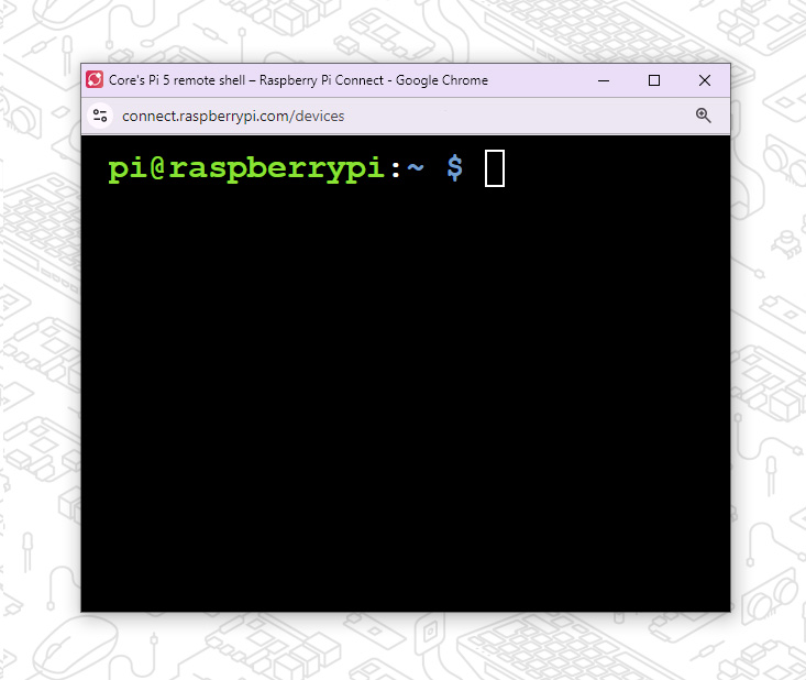

Pi Connect uses a secure, encrypted connection to beam data from your Raspberry Pi straight to the web browser of another computer, and from this browser, we can access a shell terminal of the Pi, or we can share its screen. The shell terminal uses less processing power and is better at slower connection speeds, but we can only send the Pi text-based commands like we would in a terminal window. Screensharing uses more processing and bandwidth, but it allows us to use our mouse and keyboard to interact with the pi through a browser as if we were using it normally. Best of all, this service doesn't require any additional software on the computer you are accessing it from, just a browser!

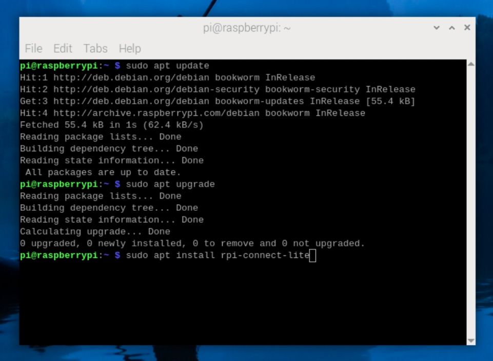

If you didn't enable this, don't worry as it's still easy to install it manually. To do so open a terminal window and start by updating your package list with:
sudo apt update
Then update your installed packages:
sudo apt full-upgrade
Then we will install Pi Connect with:
sudo apt install rpi-connect
There is also an alternative lightweight version of Pi Connect that we can install. This version will only allow you to access the shell terminal of the Pi and won't allow you to use screen-sharing.
If you wish to install this version, instead use the line:
sudo apt install rpi-connect-lite

Once you have logged in on the Pi, on the computer you wish to remotely access it from, log in to Pi Connect as well. From here you should be able to see all the devices registered to this account and can choose to connect via remote shell or screen sharing.
Note: After restarting your Pi, it may take a minute or two for it to appear under your listed devices. You may need to refresh the devices page as well.
Screen sharing is probably the best way to use it if your connection allows it (it may be a little choppy on a slow connection). In this screen-sharing window, we can also copy code from the Pi to our computer, and paste code from this computer to the Pi, as well as hit the modifier keys like ctrl and alt along the bottom. While in this window, all your mouse movements and keyboard inputs will be mimicked on the Pi.
Connection too slow? Give the shell mode a go! Or just give it a go for fun!
