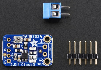

  • Mono 2.5W Class D Audio Amplifier - PAM8302
    Mono 2.5W amplifier
    This is a particularly great product from Adafruit. A $7 2.5W amplifier with differential inputs, thermal control, and onboard volume trimmer is pretty fantastic. It's super easy to use, and I've paired it in a recent project with Adafruit's 3" 4 Ohm, 3W speaker, with great success.

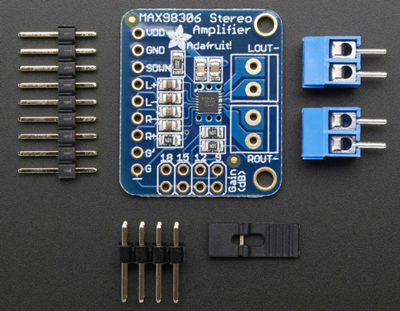

  • Stereo 3.7W Class D Audio Amplifier - MAX98306
    Stereo 3.7W amplifier
    This is the natural step up from the mono amp I mentioned above. With 3.7W of power for each channel, it can handle stereo audio for almost any maker project.

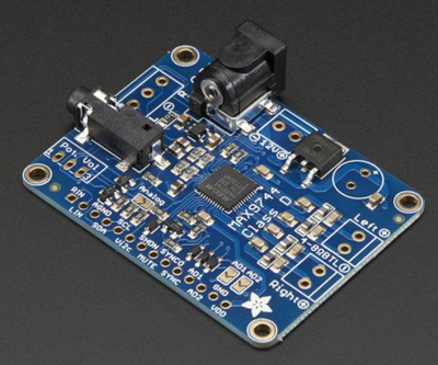

  • Stereo 20W Class D Audio Amplifier - MAX9744
    Stereo 20W amplifier
    If a smaller amplifier doesn't quite do it for you, then this 20W monster should. It packs 20W of power on each channel and also has some nice features such as an I2C interface for digital volume control, or you can use the included potentiometer.
